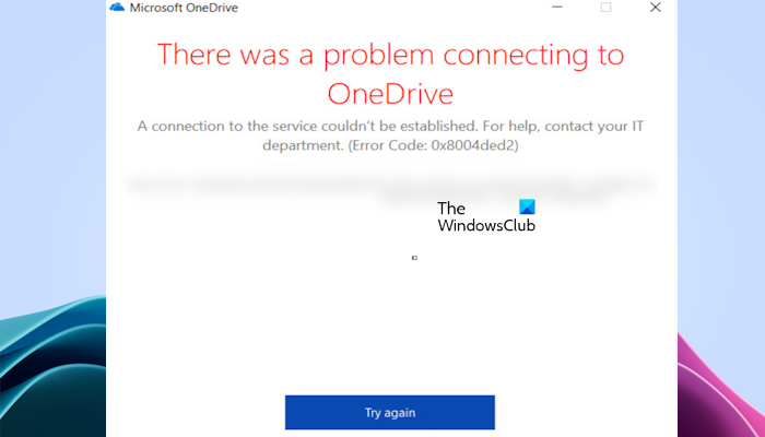

In this article, we will show you some fixes to resolve OneDrive error code 0x8004ded2. Many Windows users reported that they are getting this error while trying to add a work or school account.
The complete error message reads:
There was a problem connecting to OneDrive
A connection to the service couldn’t be established. For help, contact your IT department. (Error Code: 0x80004ded2)

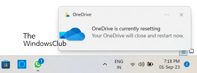

1] Reset OneDrive
Based on our experience, resetting OneDrive can fix multiple OneDrive issues. Therefore, we suggest you perform this action and see if it works. This action disconnects all your existing sync connections (including OneDrive for work or school if set up).
Open the Run command on your computer by pressing the “Window+R” key. Enter the following command and click OK.
%localappdata%\Microsoft\OneDrive\onedrive.exe /reset
You may get the following error message after executing the above command:
Windows cannot find <OneDrive location>. Make sure you typed the name correctly, and then try again.
In such a case, execute the following command in the Run command box to reset the OneDrive.
C:\Program Files\Microsoft OneDrive\onedrive.exe /reset
If you again see the “Windows cannot find…” error message, type the following command in the Run command box:
C:\Program Files (x86)\Microsoft OneDrive\onedrive.exe /reset
During the process, all existing sync connections will be terminated temporarily. You won’t lose files or data by resetting OneDrive on your computer.
