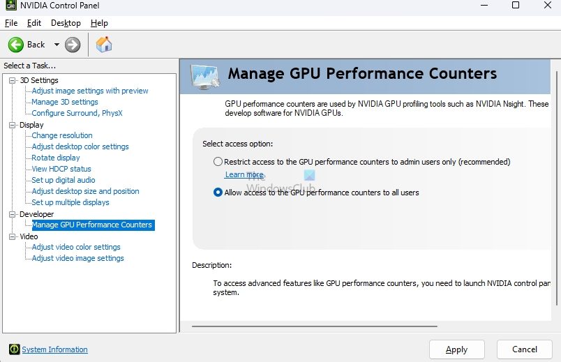

By using counters, you can monitor and control how your application utilizes the GPU. This enables you to identify performance issues and check if they have been resolved. For the scanner to work, ensure these counters are available:

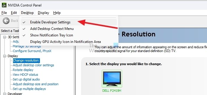

- Open the NVIDIA Control Panel from the Start Menu or the Desktop.
- Click the Desktop menu and then check the Enable Developer Settings.
- Under the task section, locate the Developer listing and select Manage GPU Performance Counters.
- Select Allow Access to the GPU performance counters for all users and restart the system for the changes to take effect.

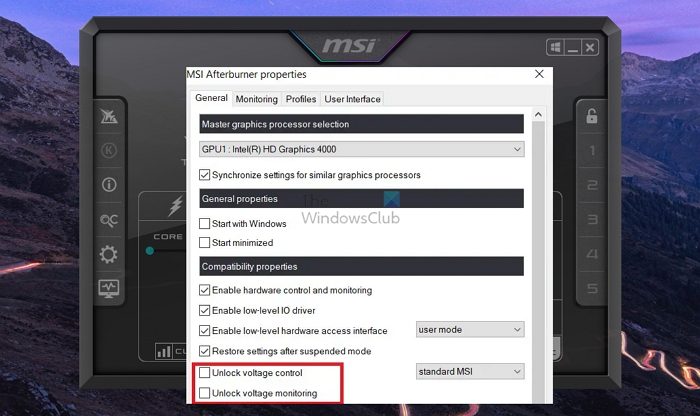

2] Unlocking Voltage control in the MSI application
When you enable these settings, the MSI software will have complete access to these settings, and issues with scanning should be quickly resolved.
- Open the MSI Afterburner application.
- Select the MSI settings option from the left.
- Enable Unlock Voltage Control and Unlock Voltage Monitoring
- Click on Apply to save the changes.

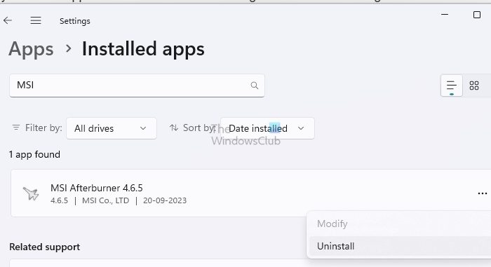

5] Uninstalling and Reinstalling MSI Afterburner:
If all the above options fail to rectify the issue, uninstallation and subsequent reinstallation of MSI Afterburner can also be worth trying.
- Go to Settings > Apps > Installed Apps.
- Type MSI in the search box, and the MSI Afterburner app listing will be available.
- Click on the three-dot menu and choose to uninstall.
- You may need to reboot your PC post-uninstallation.
- Once back into your account, download the software from the official website, install and check if the issue persists.
