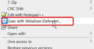

2] Run AV scan on the Word document
A corrupted Microsoft Office document could due virus/malware infection. So, you can scan the document using Microsoft Defender or any reputable third-party antivirus software to check if the file is malicious or not. Once the scan completes, see if the document can be opened now with all the contents intact. If so, then as a necessary precaution, you should run a full system AV scan.
