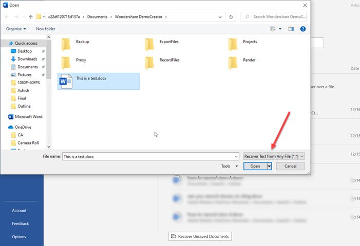

2] Use the “Recover Text from Any File” converter
Word offers a recovery tool to extract or recover text from any file. While it will result in formatting loss, images, and drawing objects, it still works if the word file is text-heavy. Recovery includes field text, headers, footers, and endnotes.
- Open Word, and then click on the Browse option
- In the file dialogue box, next to the file name text box, click on the drop-down menu
- locate and select Recover Text from Any File
- Select the document from which you want to recover the text.
- Select Open.
After the document is recovered, you may see some binary text data which were not converted. It primarily recovers text so that you can delete anything else.

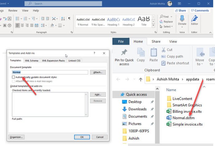

3] Change the template that is used by the document
When you create a new document, it uses a default template. There is possible corruption in the default template, causing the issue, or the template is not attached to the document. Use this when either Word document doesn’t load or is stuck there, or it shows blank.
- Double-click the damaged file, and open it.
- If it opens, then click on File > Options > Add-Ins
- In the Manage box, select Templates and click on Go.
- It will open the Templates and Add-ins window.
- If you notice this as Normal, then we need to rename the template file and reattach it. Else Skip to 9
- If it’s Normal, then close Word
- Navigate to
%userprofile%\appdata\roaming\microsoft\templates - Locate the Normal.dotm file, and rename it to something else—close Word.
- Open Word again, and navigate to File > Options > Add-Ins > Templates
- Notice that a new Normal.dotm file is again created. Select it, and click on the Attach button.
- Open the Word File, and it should work fine.
