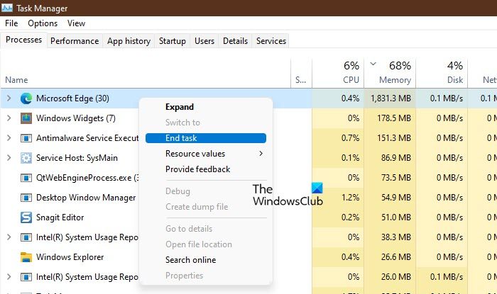

1] Try closing Edge from the Task Manager
If Edge is not closing, you can try ending the task in Task Manager. This will terminate the process and close the browser. To do the same, open Task Manager by Ctrl + Shift + Esc. Now, in the Process tab, right-click on Microsoft Edge and select End Task. Hopefully, this should close Edge for you.
