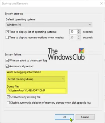

To enable the kernel dump, do the following:
- Press Windows key + R. In the Run dialog box, type control system, hit Enter to open the System applet in Control Panel, and then select Advanced system settings.
- On the Advanced tab of the System Properties dialog box, select Settings in the Startup and Recovery area.
- In the Startup and Recovery dialog box, select Kernel memory dump in the Write debugging information drop-down list.
- Make a note of the Dump File location to use in step 5, and then click OK.
