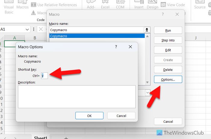

1] Check and change Macro shortcuts
It is the very first thing you need to check since you may have assigned the same keyboard shortcuts for different macros as well. Let’s say you have set Ctrl+V to run macro in Excel. Therefore, you cannot use the same traditional shortcut to paste something into your spreadsheet. In that case, you must change or remove the hotkey for that specific macro. To check and change Macro shortcuts, follow these steps:
- Open the Excel app on your computer.
- Go to the Developer tab.
- Click on the Macros option.
- Select a predefined macro from the list.
- Click the Options button.
- Select a new keyboard shortcut.
- Click the OK button.

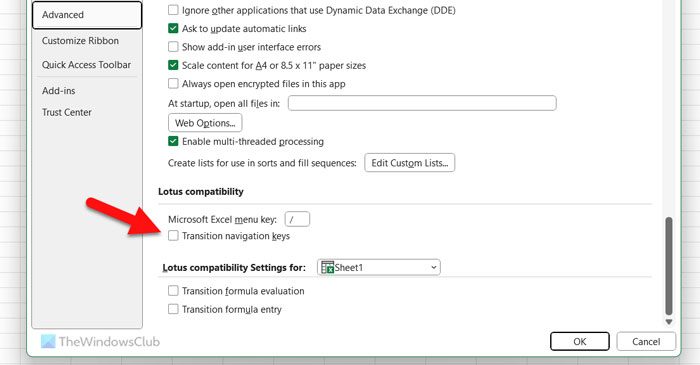

3] Turn off Transition navigation keys
Transition navigation keys help you execute different tasks using the same keyboard shortcut. Having said that, it could also create a problem with your keyboard shortcuts in Excel. Therefore, it could help if you turn off this setting. To turn off the Transition navigation keys, follow these steps:
- Open the Excel app.
- Click on the File menu.
- Select the Options.
- Switch to the Advanced tab.
- Head to the Lotus compatibility section.
- Remove the tick from the Transition navigation keys checkbox.

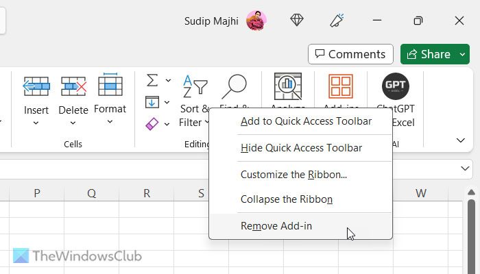

4] Remove add-ins
At times, having countless add-ins could also cause the same problem. Although Application Add-ins and Document Related Add-ins do not create such a problem, you might find the issue after installing third-party add-ins. Therefore, it is suggested to remove the most recently installed add-ins one after one to check if it resolves your problem or not.
For that, you can right-click on the add-in icon and select the Remove Add-in option.
Click the Yes button on the confirmation window to get the job done.

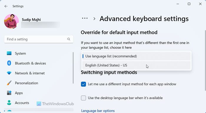

5] Change default input method
Having an entirely different language (e.g., English alongside Spanish) set could also cause this problem in Excel. Therefore, you can switch to English and check if that does anything positive or not. To change the default input method, follow these steps:
- Go to Time & language > Typing > Advanced keyboard settings.
- Expand the drop-down list.
- Select English (United States) – US option.
