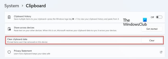

When you find that your system is being infected with Clipboard Hijacker, the first thing you should do is clear your clipboard. This is to ensure that the clipboard will no longer hold any fraudulent wallet address that has been swapped in place of your intended address by the virus. Follow these steps to clear the clipboard data on your Windows 11/10 PC:
- Click on the Start menu icon on your Windows taskbar.
- Select Settings.
- Under System Settings, navigate to the Clipboard option.
- Click on this option to open the Clipboard settings.
- Click on the Clear button next to the Clear clipboard data option.
