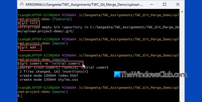

Open File Explorer and navigate to your project folder. Right-click inside the folder (any blank area) and select “Git Bash Here”.
This will open Git Bash with the working directory already set to your project folder. Run the following command to initialize Git in your project folder:
git init
The above command creates a hidden .git folder where Git tracks all version history.
Next, run the following command to stage all the files in your project to prepare them for commit:
git add .
Next, create your first commit with a meaningful message:
git commit -m "Initial commit"
You’ve now saved your project’s current state into Git’s version history locally.

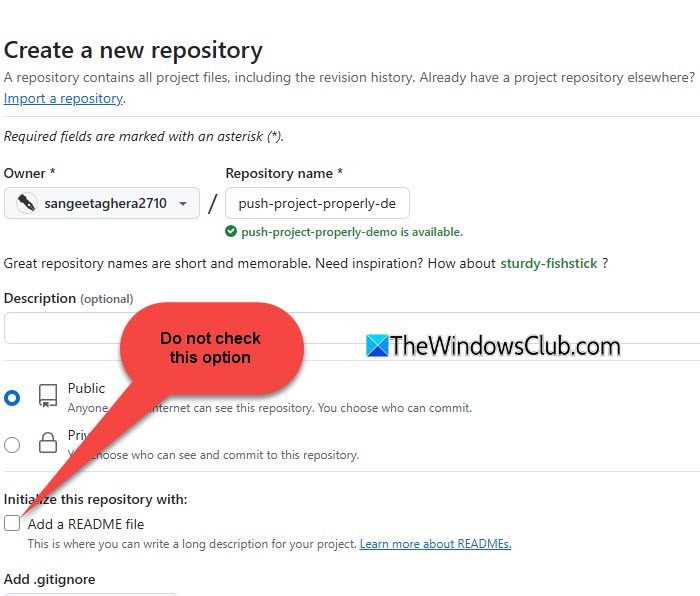

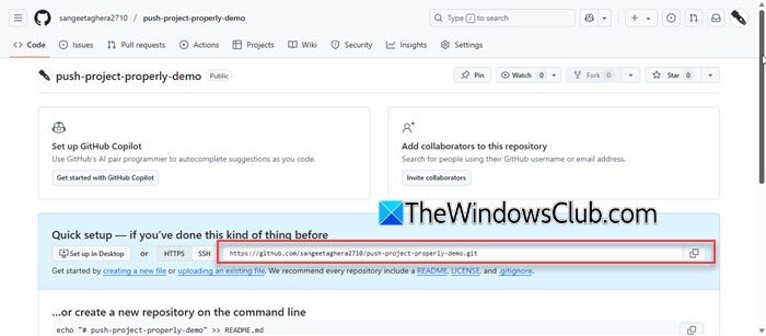

Next, go to GitHub and create a new repository.
Make sure you don’t initialize it with a README, .gitignore, or license. Copy the repository URL (choose HTTPS).

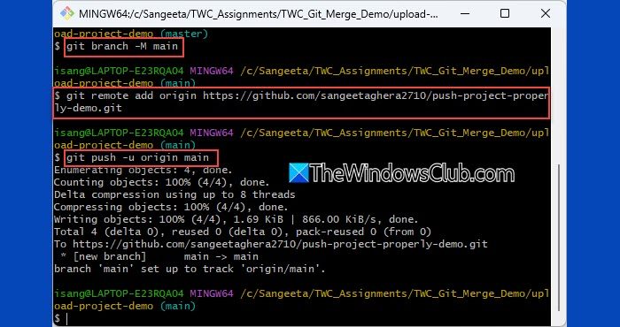

Go back to Git Bash and run:
git remote add origin https://github.com/sangeetaghera2710/push-project-properly-demo.git
(Replace the URL with your actual repository link.)
This command connects your local project with the GitHub repository by adding a remote reference named “origin”. Now that your local project is linked to the remote GitHub repository, you can push your commits through this command:
git push -u origin main
The above command uploads your local main branch to the origin remote (your GitHub repo) and sets it to track future changes.
Note: In older Git setups, the default branch name may be master instead of main. If your branch is called main, the above push command will work. If your branch is called master, use this instead:
git push -u origin master
If you’d like to switch to the modern default (main), you can rename the branch before pushing:
git branch -M main git push -u origin main

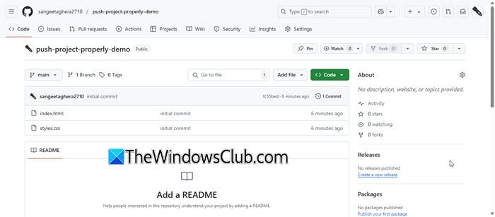

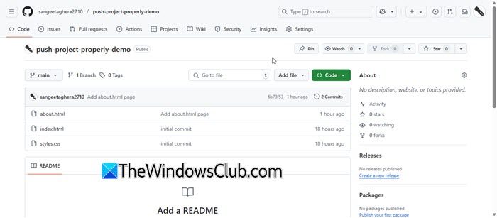

Now, when you refresh your GitHub repo page in the browser, you’ll see all your project files listed there, just like they appear in your local folder.

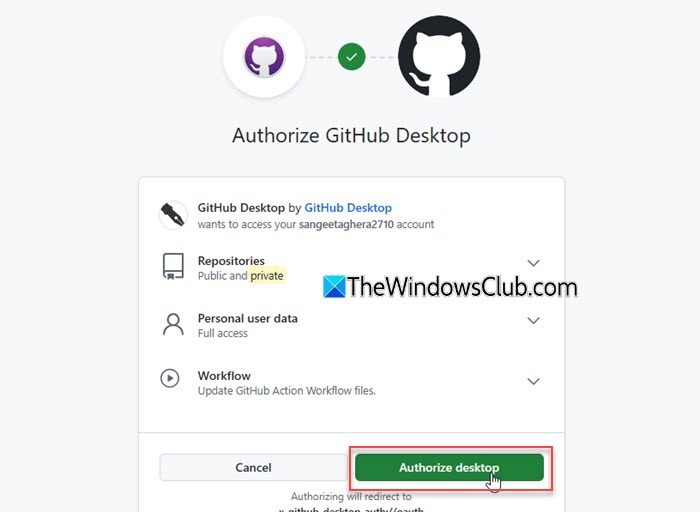

Download and install GitHub Desktop using this link. Launch the app and sign in with your GitHub account.

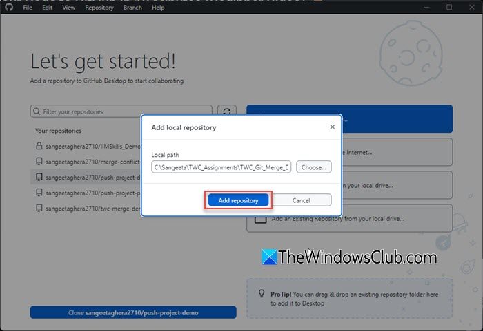

Click Add local repository, and select the folder containing your existing project (which you already pushed using Git Bash).

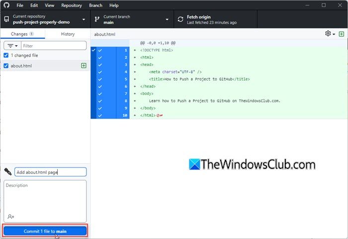

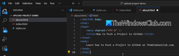

Next, open the project folder in Visual Studio Code and add a new file (e.g., about.html).

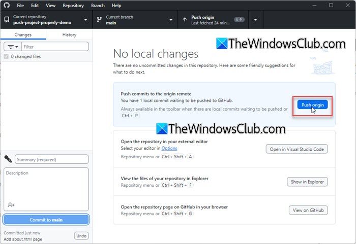

Switch back to GitHub Desktop. It will automatically detect the newly added file and list it under Changes.
Enter a commit message like “Add about.html page”. Click Commit to main (or your current branch name).
After committing, click the Push origin button in the top right corner. Your changes will be uploaded to the connected GitHub repository.
Open your repo on GitHub.com and refresh to see the new file.
