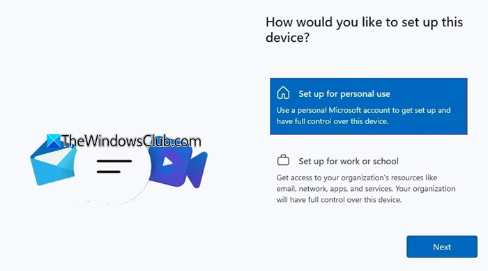

You can install Windows 11 25H2 with a Local account instead of a Microsoft account. During setup, you should choose Set up for work or school > Domain join instead to create a local account. This bypasses the Microsoft account requirement.

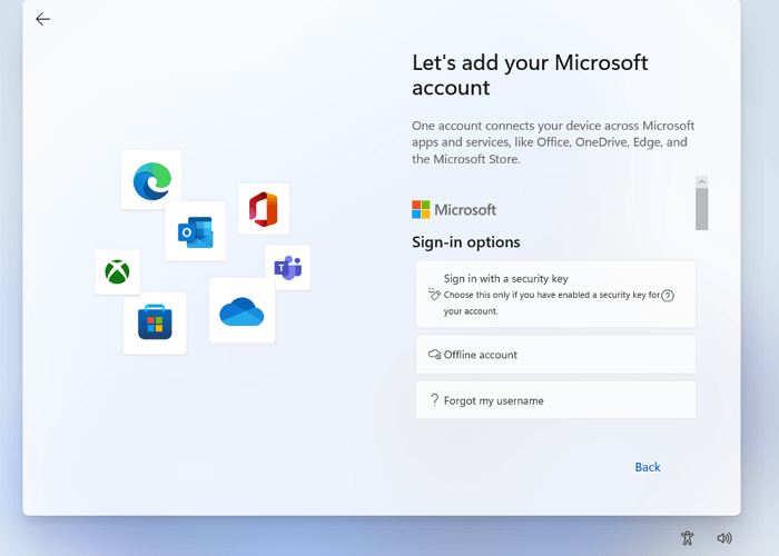

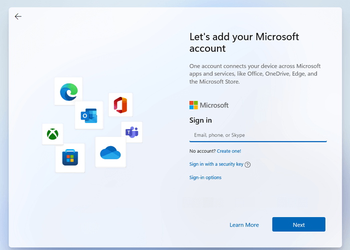

- After completing all the processes, you will finally reach the Account Login screen.
- Click on the Sign-in options. Then on the option Offline Account.
- Check the option that reads Limited Experience or Skip for now.

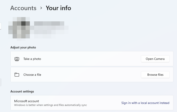

How To Switch Your Microsoft Account To A Local Account in Windows 11?
Here are some simple steps that you can follow to switch back to a local account from a Microsft account:
- Open Settings and navigate to Accounts > Your Info
- Select the option that says Sign in with a local account instead.
- Enter the existing password that you use for your Microsoft account to confirm authorization
- Enter the Name and password for the new local account that you’ve just created with hints.
- Click on next to sign out of the Microsoft account and start using your new local account.
