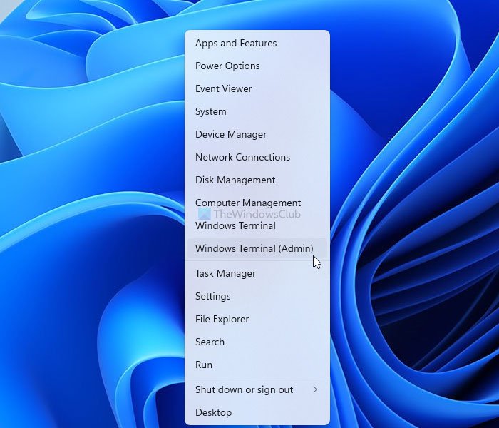

1] From Win+X menu
Microsoft introduced Win+X menu a long time back in Windows 8. This additional menu includes several options and apps that you can open on your computer. Earlier, it was possible to open Command Prompt or Windows PowerShell with and without administrator permission. However, now you can open Windows Terminal from the Win+X menu with and without administrator privilege. For that, press Win+X and select the Windows Terminal (Admin) option.
Then, you can select the Yes option in the UAC prompt.

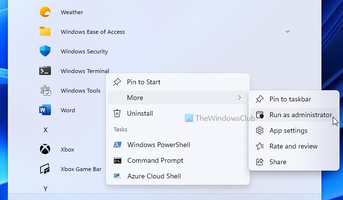

2] From Start Menu/Taskbar search box
It is yet another simple method that you can use to open Windows Terminal as an administrator in Windows 11. You can use Start Menu to find out the app and the Taskbar search box to do the same. If you click on the Start Menu, it displays a list of apps on your screen. Then, click on the All apps button to find out all the installed apps.
From here, find out the Windows Terminal, right-click on it, and select the Run as administrator option.
As you are opening this app as an administrator, you have to click on the Yes option in the UAC prompt.
Alternatively, you can use the Taskbar search box to find out Windows Terminal, right-click on it and select the Run as administrator option.
As usual, click the Yes option.

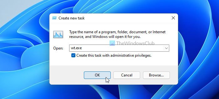

3] From Task Manager
Task Manager allows users to open any app with administrator permissions. In Windows 11, there is no change in that functionality. Therefore, follow these steps to open Windows Terminal as an administrator using Task Manager:
- Press Win+X to open the menu and select Task Manager.
- Click on File > Run new task.
- Type wt.exe and tick the Create this task with administrator privilege checkbox.
- Click the OK button.
