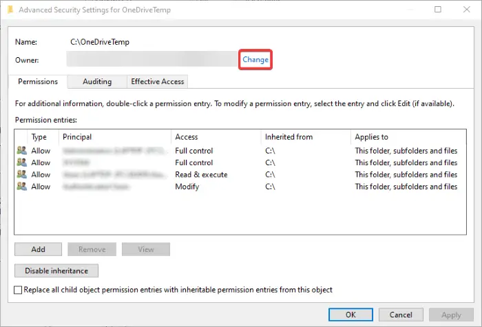

2] Take Ownership of Folders
Taking full ownership of files and folders will enable you to access restricted folders in Windows 10. You might be unable to access some folder in case of version update or due to unintentional modifications in user control options. So, take ownership of folders again to access the restricted folders on your PC. To do so, you can follow below steps:
Firstly, right-click on the restricted folder you want to access and then click on the Properties option. Then, go to the Security tab and press the Advanced button.
Now, click on the Change button which is present besides the Owner option.

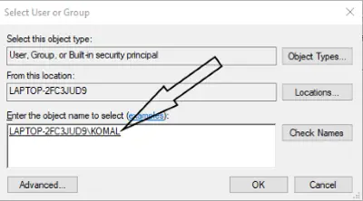

Next, in the Enter the object name to select section, type your username, and then tap on the Check Names button. The username will be automatically applied in order if you entered the correct username. If all good, click the OK button next.

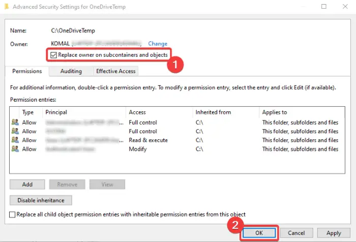

After that, you need to enable the checkbox named Replace owner on sub containers and objects and then press the OK button.
This should enable you to access the restricted folder that you were unable to access previously.

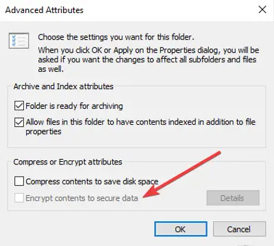

Simply right-click the folder and click on the Properties option and then from the General tab, click on the Advanced button. In the Advanced Attributes window, you will see an Encrypt contents to secure data option.
If it is checked, the folder is encrypted. So, now, you need to check with the user who has encrypted the folder and then decrypt it using the right certificates to access the folder.

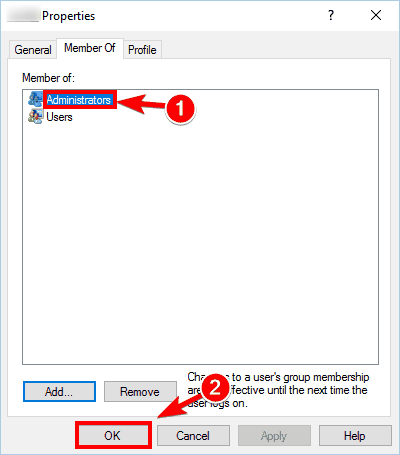

5] Add account to Administrator Group
Adding your account to the administrator group may help you access a restricted folder on Windows 10. In case you want to provide someone else access to the restricted folders, you can add his/her account to the administrator group by following the below steps:

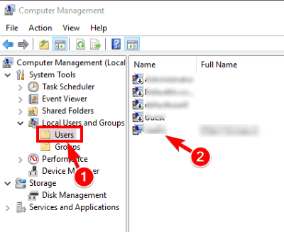

Click Windows + X hotkey and select Computer Management from the pop-up menu. In the Computer Management window, go to the Local Users and Groups > Users menu and double click on your user account from the right panel.

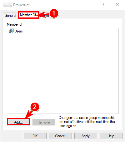

Go to the Member Of tab and press the Add button.

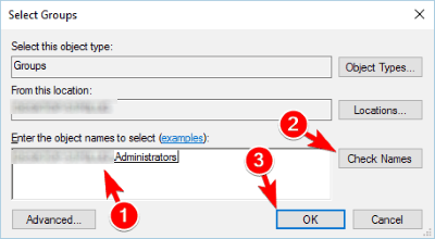

Now, type Administrators in Enter the object names to select field and tap on the Check Names button. If all good, press OK.
Next, select Administrators and then click Apply > Ok option.
Restart PC and see if you can access restricted folders.
