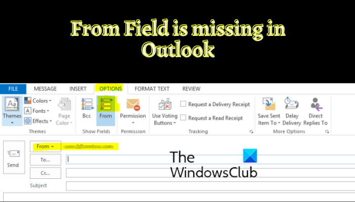

1] Manually add the From field

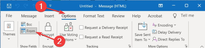

You can try adding the From field in your emails manually. It might be the case that you have hidden the From field in emails in your View settings knowingly or unknowingly. So, you can modify the View settings and manually show From field in emails. To do that, you can follow the below steps:
- First, open Outlook and create a new email using the respective option.
- Now, go to the Options tab present on the ribbon.
- Next, choose the From option from the Show Fields group.
You should now be able to view the From field in your emails.
If the problem persists, you can use the next method to fix the issue.

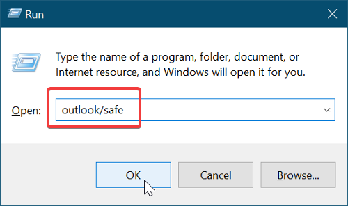

4] Run Outlook in Safe mode
The next thing you can do is run the Outlook application in safe mode. In safe mode, Outlook will start without external add-ins and customizations. So, if there is any third-party add-in that is interfering with the regular working of the app and causing this issue, this method will fix the issue. Here are the steps to do that:
- First, press Win+R to open the Run command box.
- Now, type the following command in the Open field:
outlook.exe /safe
- Lastly, press the Enter button and the Outlook app will start in safe mode.
If the From field is showing in safe mode, there must be a problematic add-in that is causing the issue. You can try disabling to removing such add-ins from Outlook to permanently resolve the problem. Here’s how:
