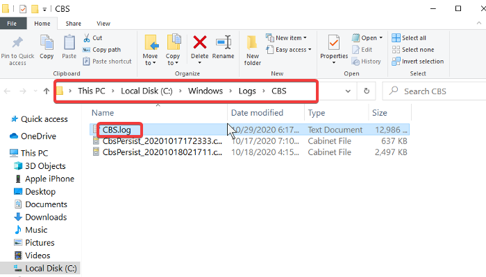

3] Rename the CBS.log file
Press the Windows key and type in the following string:
%systemroot%\Logs\CBS
It takes you to Local Disk (C:) > Windows > Logs > CBS.
Rename the CBS.log file to a CBSold.log.
If you are unable to rename the CBS.log file, fix it with the steps below:
- Press the Windows key + R combination to open the Run dialog box.
- Type Services.msc in Run and click OK.
- Find and double-click on the Windows Modules Installer service.
- Change the startup type to Manual.
- Restart your machine.
You should be able to rename the CBS.log file after following the above steps. When you rename it, return to the Windows Modules Installer service and change the startup type back to Automatic.
Remember to reboot your PC after renaming the file.
