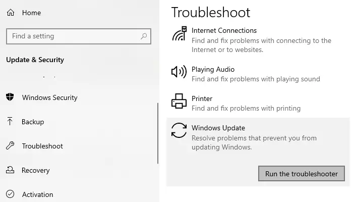

1] Run Windows Update troubleshooter
Sometimes the update error occurs temporarily and it can be resolved just by performing the Windows Update troubleshooter.
To do this, open the Windows Settings using Win+I keyboard shortcut. Thereupon, go to Update and Security and then select the Troubleshoot tab. Move to the right pane, select Windows Update, and then hit the Run the troubleshooter button.
Furthermore, you can also try Microsoft’s online troubleshooter and check whether it helps you to get rid of this problem.
