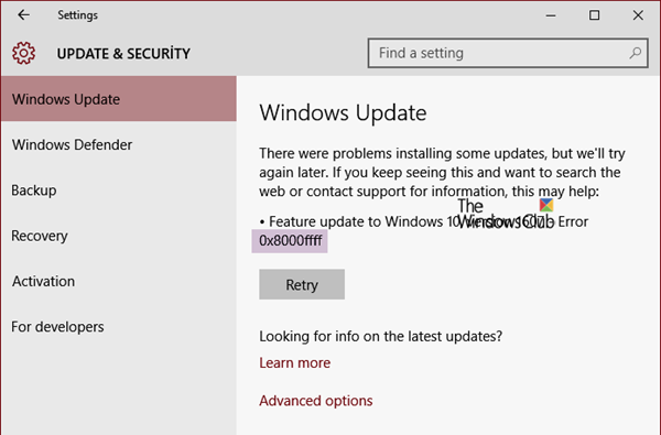

While running Windows Update if you receive error code 0x8000FFFF, E_UNEXPECTED – Unexpected failure then this post offers some working fixes. It can even occur when updating Microsoft Store apps. Here are a few things you could try to fix the issue.
Microsoft Store or Windows Update Error 0x8000FFFF
Here are a few things you could try to fix the 0x8000FFFF, E_UNEXPECTED – Unexpected failure error:
