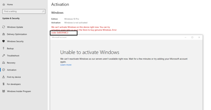

Windows Activation Error 0x803FABC3 indicates that the device is not eligible for transfer because the device is blocked. If you are also facing the same error, continue with the troubleshooting guide to avoid and resolve the issue on Windows 11/10.
Regardless of the Windows version you are using, the error pops up with the following message-
We can’t activate Windows on this system right now. You can try activating again later or go to the store to buy genuine Windows. Error code: 0x803FABC3
The worst part is that there is no difference in the situation even after going through the Activation troubleshooter. Upon running the Activation troubleshooter, Windows displays the following message-
Unable to activate Windows. We can’t reactivate Windows as our servers aren’t available right now. Wait for a few minutes, or try adding your Microsoft account again.
Continue with the guide to fix the problem.
