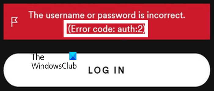

Another instance of Spotify error code 2 where you may get the following error message:
The username or password is incorrect.
(Error code: auth:2)
This error message indicates that the entered username or password to sign into Spotify is not right.

1] Check your username and password
If you are getting this error code with an error message saying “username or password is incorrect,” you must ensure that the username and password you have entered are correct. So, check your login credentials and enter the correct username and password to sign into Spotify.

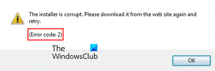

3] Re-download the installer file of Spotify
If you get this error when installing the app on your PC, it is likely that the installer file is corrupted. Hence, delete the existing installer file and re-download the Spotify installer from the official website. After that, run the installer and check if you can install Spotify without error code 2.

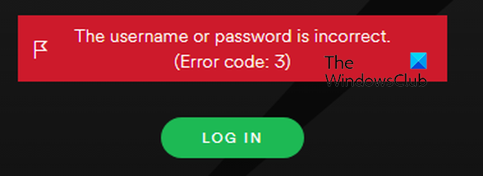

Fix Spotify Error Code 3
Spotify error code 3 is another error when signing into Spotify in a web browser or desktop app. It is similar to error code 2, which prompts the following error message:
(Error code: 3)
If you get this error code, ensure you have entered the right login credentials. In case the username and password are correct yet you get this error code, here are the solutions you can use to fix the error:
- Reset your Spotify password.
- Try a different login method.
- Switch off your VPN.
1] Reset your Spotify password
You can try resetting your password and then log into Spotify to check if the error is resolved.
2] Try a different login method
Spotify provides different login methods to sign into your account. Apart from using login credentials, you can also use any of these login methods: Continue with phone number, Continue with Apple, Continue with Google, and Continue with Facebook. So, if you get the error code 3 when logging in with username and password, try another login method and see if it helps to resolve the error.
3] Switch off your VPN
If you are using a VPN on your PC, it might cause connection issues on Spotify and result in error codes like 3. So, turn off your VPN and then see if the error is fixed.

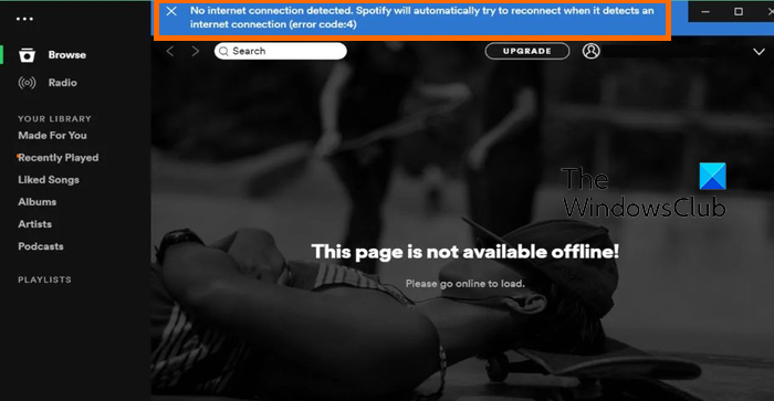

Fix Spotify Error Code 4
You may receive the following error message when error code 4 is triggered:
No internet connection detected. Spotify will automatically try reconnecting when it detects an internet connection error code: 4)
Spotify error code 4 pops up while using the app if there is no internet connection detected. While the error code is most likely to be caused due to a weak internet connection or network issues, there can be other reasons for this error. It can be caused due to firewall blockage or interferences. Now, to fix this error code, here are the fixes you can use:
- Make sure your internet connection is stable.
- Change your DNS server.
- Change your proxy settings in Spotify.
- Allow the Spotify app through your firewall and antivirus.
- Clear the Spotify cache.
1] Make sure your internet connection is stable
As this error is primarily caused due to a weak internet connection, make sure you are connected to a stable and good-speed internet connection. Try connecting to a different internet connection and see if it helps in resolving Spotify error code 4.
2] Change your DNS server
DNS server inconsistencies can also cause this error code on Spotify. So, you can try switching to a more reliable DNS server like Google DNS and see if error 4 is stopped. Here’s how:
- Firstly, open the Run command box using Win+R and enter ncpa.cpl to open Network Connections.
- Next, right-click on your internet connection and click on the Properties option.
- After that, select the Internet Protocol Version 4 (TCP/IPv4) option and hit the Properties button.
- Now, click on the Use the following DNS server addresses radio button and type the following addresses as mentioned below:
Preferred DNS server: 8.8.8.8 Alternate DNS server: 8.8.4.4
- Lastly, click on Apply > OK and restart Spotify to check if the error is resolved.

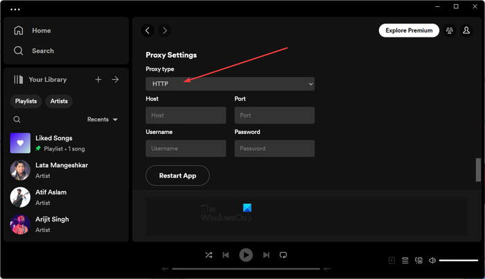

3] Change your proxy settings in Spotify
The next thing you can do to fix Spotify error code 4 on Windows is to change Spotify’s proxy settings. Here are the steps to do that:
- First, open the Spotify app on your PC and make sure you are logged in.
- Now, click on the three-dot menu button present in the top-left corner and select the Edit > Preferences option.
- Next, scroll down and locate the Proxy Settings section.
- After that, click on the Proxy type drop-down button and choose the HTTP option.
- Finally, click on the Restart app button to relaunch the app and check if the error is resolved.
