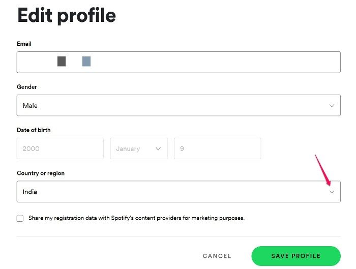

4] Change the Country
You will also face the Spotify error code 30 if you have recently switched countries. As a solution, you will have to change the Spotify account country to fix the problem. To do so, here are the steps you need to follow.
- Launch the Spotify app and log in with your credentials.
- Tap on the profile picture and choose Account.
- Click on Edit Profile under the Profile option.
- Click on the dropdown icon present under Country or region, and choose your current country.
- Tap on the Save Profile.
Now, relaunch the app and check if the problem is fixed.

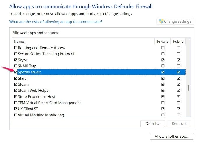

5] Allow Spotify from Windows Firewall
Sometimes custom Firewall settings can also act as a barrier to the smooth functioning of an application including Spotify. Firewall settings can stop Spotify from communicating with the server. Thus, you will have to allow Spotify from the Windows Firewall, which will ensure that it doesn’t block any service. Here are the steps you need to follow.
- Press the Windows key to open the start menu.
- In the search bar, type Windows Firewall and press enter.
- Click on Allow an app or features through the Windows Defender Firewall option present at the left panel of the screen.
- Tap on Change settings, and look for Spotify music.
- Checkmark both the Private and Public options.
Save the settings and restart your system. Launch Spotify and check whether the problem is fixed.

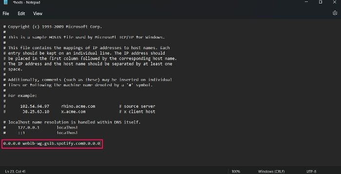

6] Edit the Hosts File
Editing the Hosts file of Spotify is another effective workaround you can try. Here are the steps you need to follow.

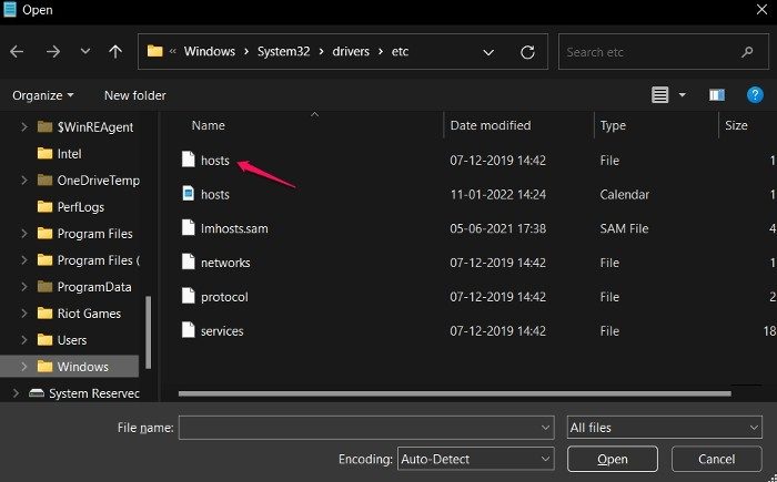

Open Notepad on your system in administrator mode.
In the Notepad window, press Ctrl + O
Navigate to the below-mentioned location.
C:\Windows\System32\drivers\etc
In the location, type on the dropdown icon and choose All Files.
Double-click on hosts to open the file.
Check whether you can find the entry mentioned below in the file. If yes, simply delete it.
0.0.0.0 weblb-wg.gslb.spotify.com0.0.0.0
If the entry is found, delete it.
Once done, press Ctrl + S to save the file.
Now, open Spotify and check if the problem persists.
