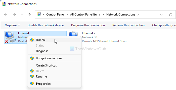

3] Re-enable network adapter
You can enable or disable the network adapter or port on your computer using the in-built options. For that, you have to follow these steps:
- Type ncpa.cpl and hit the Enter button.
- Right-click on your Ethernet connection.
- Select the Disable option.
- Again right-click on the Ethernet adapter and select the Enable option.
Now check if you can access the internet on your computer or not.

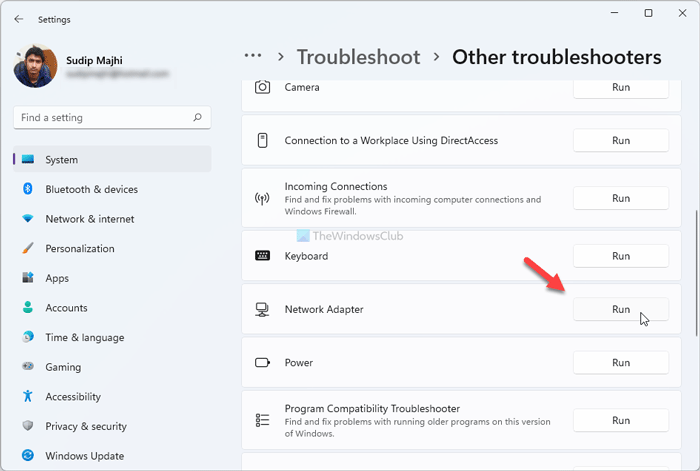

5] Run Network Adapter troubleshooter
Troubleshooters help you fix common issues within moments on Windows 11/10. If there are some internet problems in the network adapter, you can fix them by running the Network Adapter troubleshooter. For that, you can do the following:
- Press Win+I to open the Windows Settings.
- Go to System > Troubleshoot if you are using Windows 11.
- Go to Update & security > Troubleshoot if you are using Windows 10.
- Click on the Other troubleshooters menu.
- Find out the Network Adapter troubleshooter and click the Run button.
- Follow the screen instructions.
It displays possible causes and solutions so that you can get rid of Network cable unplugged error on Windows 11/10.

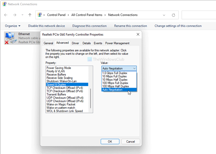

6] Change Speed & Duplex
If you have recently changed the Speed & Duplex setting for your Ethernet connection, and the problem has started after that, you need to revert the change. In case you do not remember the default setting, you can reach out to your ISP or set it as Auto Negotiation. For that, do the following:
- Press Win+R, type ncpa.cpl and press the Enter button.
- Right-click on the Ethernet and select the Properties option.
- Switch to the Advanced tab.
- Find out the Speed & Duplex option.
- Choose Auto Negotiation from the drop-down list.
Restart your computer and check if the problem has been resolved or not.
