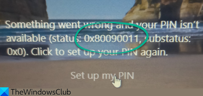

While setting up Windows Hello in Windows 11/10 PC, many users have reported facing error 0x80090011 during the Create a PIN step. The error message mainly occurs if the container or key was not found. To be specific, the Hello PIN Error 0x80090011 says,
Something went wrong and your PIN isn’t available. Error: 0x80090011
So, if you are also facing the same error message, then continue with this troubleshooting guide to solve the problem.

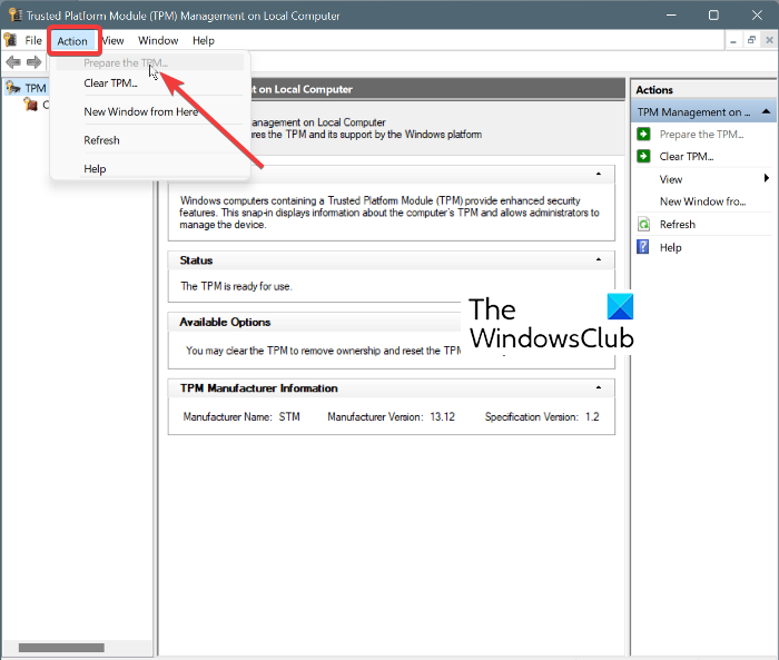

4] Change the TPM settings
The next thing you can do is try to access the TPM and change its settings. Below are the steps you need to follow to get the work done.
- Open the Run dialogue box by pressing Windows + R shortcut key.
- Type tpm.msc and press the enter key.
- Click on the Action option present at the top left corner of the screen.
- From the context menu, select Prepare the TPM.
- Exit the window and restart the system for changes to take effect.

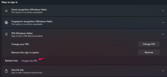

6] Create a new PIN
If none of the above-mentioned workarounds helped you in solving the problem, you could go with creating a new PIN. It’s very easy to create a new PIN on a Windows PC. Just follow the below steps to find out how it’s done.
- Press the Windows + I hotkeys to open the Settings menu.
- Navigate to Accounts > Sign-in options.
- Click on the dropdown icon present next to PIN.
- From the context menu, choose I forgot my PIN.
- Now, follow the onscreen instructions to reset the PIN.
