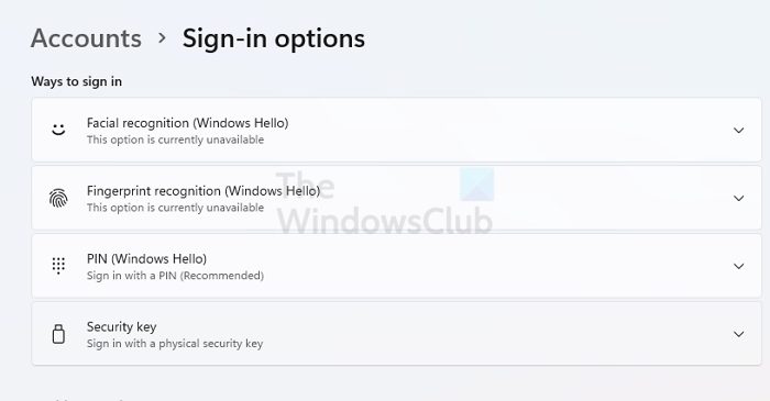

One of the forum users experienced a strange issue where even though Windows Hello was enabled, Sign-in using facial recognition did not work. Along with the screen displayed— Your credentials could not be verified error. The user was forced to sign in using the account password. So neither the PIN worked nor the Face recognition worked.
Your credentials could not be verified – Windows Hello

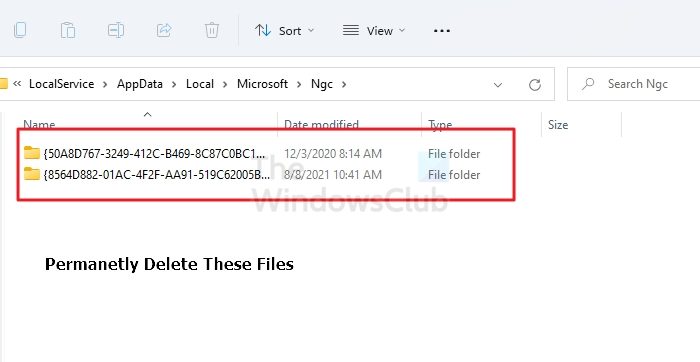

- Open File Explorer (Win + E) and navigate to the following location:
C:\Windows\ServiceProfiles\LocalService\AppData\Local\Microsoft\NGC
- Use Ctrl + A, and delete everything within that folder. If you don’t see the folder, then enable the show hidden files, folders, and drives option in File Explorer.
- If promoted with a Continue, then click Yes.

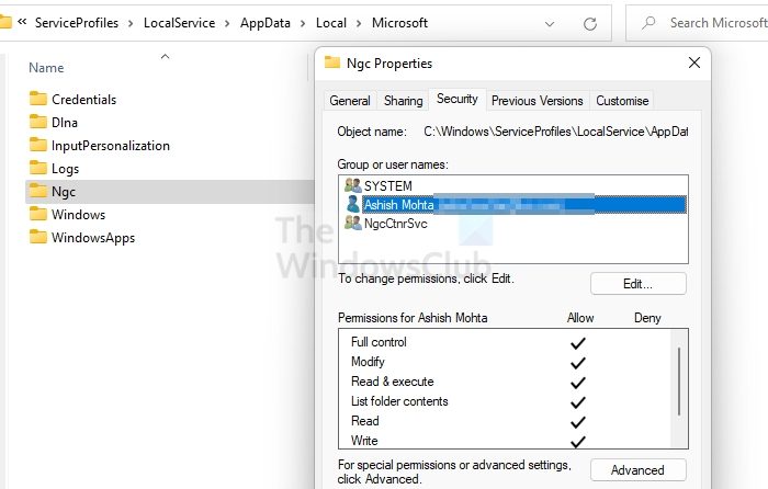

If you get the message— You don’t currently have permissions for this folder, then you need to change the folder’s permission.
- Righ-click the NGC folder and go to properties and click the Security tab.
- Click Advanced.
- Click Change beside Owner and type in Administrators and click OK.
- Restart PC.
I was able to get access to the NGC folder. You may need to reboot the PC after adding the account.
Now try emptying the NGC folder again. Done that, close all the open folders, and then go ahead and reset the PIN.
- Go to Windows Settings
- Navigate to Accounts > Sign-in Options
- Click Add a PIN again and set your PIN
Do the same for Face recognition, and check if the issue is resolved.
