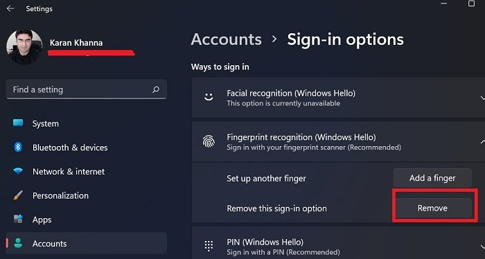

How to remove Fingerprint from Windows Hello in Windows 11
The procedure to remove Windows Hello fingerprint login is fairly simple.
- Right-click on the Start button and select Settings.
- In the Settings menu, go to the Accounts tab on the list on the left-hand side.
- In the right-pane, click on Sign-in options.
- In the Sign-in options window, expand the list for Fingerprint recognition (Windows Hello).
- No matter how many finger have been set, you get only one option to Remove the fingerprint login system.
- Please click on it to remove Fingerprint from Windows Hello in Windows 11.
