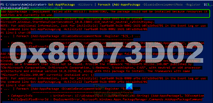

The complete error message is:
Add-AppxPackage : Deployment failed with HRESULT: 0x80073D02, The package could not be installed because resources it modifies are currently in use.
error 0x80073D02: Unable to install because the following apps need to be closed
<app or process name>
In the above error message, you will see the name of the app or process in place of the “app or process name” that is needed to be closed. The error codes could also be different depending on your scenario, but the solutions are essentially the same.

The error message is self-explanatory. If you read it carefully, the name of the app or process causing the problem is displayed at the end of the message. According to the error message, the command to re-register the app cannot be executed because the app is not closed. It means that the app or process, the name of which is displayed in the message, is running in the background. To fix the problem, you have to end that app or process. The steps to do this are written below:
- Press the Win + R keys.
- When the Run command box appears, type taskmgr and click OK. This will open the Task Manager.
- In the Task Manager, select the Processes tab and look for the app or process, the name of which is displayed in the error message.
- Once you find it, right-click on it and select End Task.
After performing the above steps, you should be able to re-register the app via Windows PowerShell. If this does not help, try the next solution.
