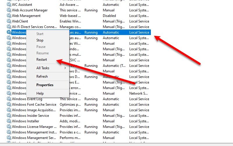

7] Restart Windows Audio Service
If you are still not able to fix the Bluetooth sound delay issue then try restarting Windows Audio Service.
To do that, launch Services from the Start Menu, scroll down a bit, right-click on Windows Audio, select Restart, and click Yes to confirm.
Finally, restart your computer, connect to the Bluetooth device and enjoy.
