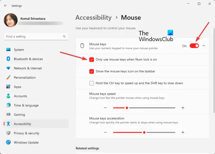

1] Switch on Mouse Keys while Num Lock is enabled
To fix the issue, enable Mouse Keys when NUM LOCK is ON. To do that, press the left ALT + left SHIFT + NUM LOCK key combination on your keyboard. After that, press the Yes button on the prompted dialog. You can also do the same using your Windows Settings. Here are the steps to do that:
- First, open the Settings app using Win+I and click on the Accessibility tab from the left pane.
- Now, from the right-side pane, select the Mouse option under the Interaction section.
- After that, enable the toggle associated with the Mouse keys option.
- Next, tick the Only use mouse keys when Num lock is on the checkbox.
Once done, you can try using the ALT codes and see if the problem is fixed or not. If not, you can play the next fix to resolve this issue.

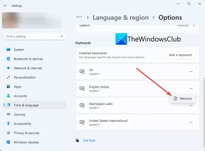

4] Switch to another Keyboard Layout
You can also change your current keyboard layout to a different one and see if the problem is resolved or not. To do that, you can try the following steps:
- First, launch the Settings app and go to the Time & language tab.
- Now, click on the Language & region option and select a different keyboard layout under the Keyboards section.
After doing so, check whether you can use the ALT codes on your PC.
