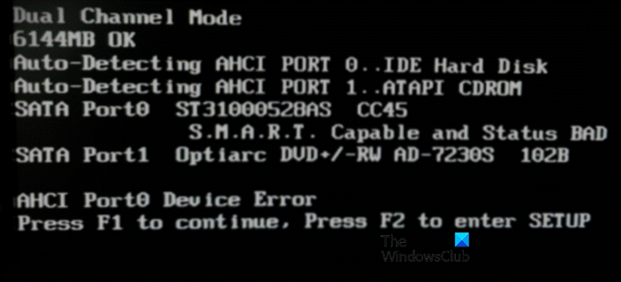

If, every time you turn on the computer, an error message appears on the screen saying AHCI Port0 Device Error, Press F1 to continue, Press F2 to enter SETUP, then this post will help you resolve the issue.
What is the AHCI Port0 Device Error?
The AHCI device error is generated from BIOS. SMART has detected that your hard drive at port 0 is faulty, and the drive may or may not be accessible. Your hard drive can fail at any time. If you are using a desktop if you can, try to change the port where the hard disk is connected. If you still encounter the issue, this might be due to hard disk itself. You can troubleshoot the issue by running the Check Disk utility, disabling the failing hard drive, and checking the port.

To get started, press F1 when you see this error screen to go to your desktop. Once here, to be safe, backup your files to an external hard drive.
1] Check Physical Connectivity
First of all, we should restart the computer. Sometimes by doing this such issues get resolved. If restarting the computer doesn’t fix the problem, then make sure that all cables connecting the storage device to Port 0 are securely plugged in. If you have a spare SATA cable then use that cable, this could help resolve such an issue.

5] Replace the hard drive
If you cannot resolve the said error using the above solution, then replacing the storage device will be the best option. But before replacing the storage device, we should connect our storage device to a different port. If everything is ok, then there is no need to do anything. But if this does not solve the problem, we must replace the storage device.
