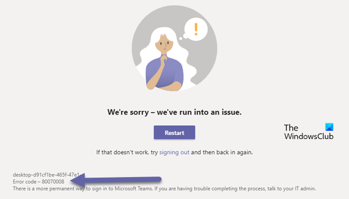

Microsoft Teams in the present time has become quite an important tool for work. And some of the errors plaguing the app are quite irritating, to say the least. In this article, we will tackle one such error code, 80070008, which is stopping users from logging in to their accounts. So, if you get the Microsoft Teams Error Code 80070008, follow the solutions mentioned in this post.
We’re sorry – we’ve run into an issue, Error Code – 80070008
Why am I getting an error message while logging in to MS Teams?
Some of the causes for getting the login error in Teams include corrupted caches of the app and the browser, Server problems for the service, bad internet connection, or it could be a glitch.
Fix Microsoft Teams Error Code 80070008
If you are having trouble logging in or signing in to Teams, and the error code 80070008 is pooping continuously on the screen, execute the solution mentioned below:
