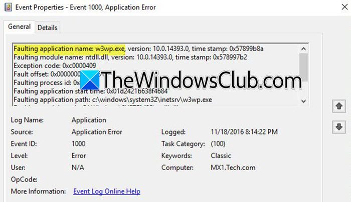

1] Faulting application name w3wp.exe
The w3wp.exe process is the IIS (Internet Information Services) worker process that handles web requests for applications running on your server. This issue is nothing but a bug that is caused by Microsoft Monitoring Agent (which is installed on your system). You can open the Control Panel, go to Control Panel\Programs\Programs and Features, and then uninstall the application. If you want it back, you can go to your Azure portal and install it from there.

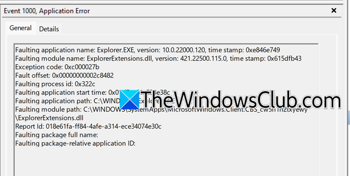

5] Faulting application name explorer.exe

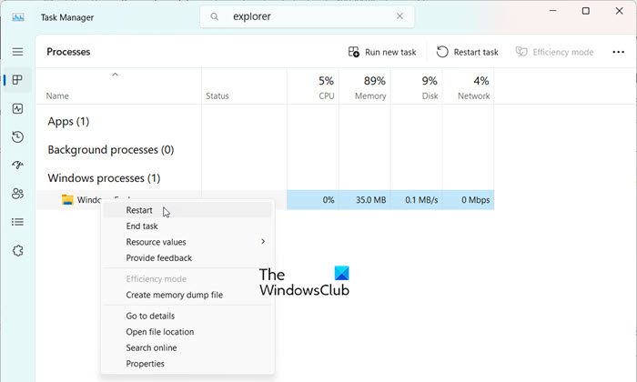

The explorer.exe process is responsible for the Windows File Explorer. When it crashes, it can cause your desktop or File Explorer to become unresponsive or restart repeatedly.
In case File Explorer keeps restarting or becomes unresponsive, users are recommended to restart Windows Explorer to resolve temporary glitches or issues. To do so, Click Ctrl + Shift + Esc to open the Task Manager, and find Windows Explorer in the list. Right-click on it and select the Restart option. Furthermore, ensure that the Graphics Driver is up-to-date, and if the issue persists, run System File Checker and DISM. This should resolve the issue.
Fix: ExplorerExtensions.dll crashes with Event ID 1000

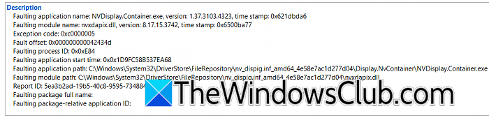

8] Faulting application name NVDisplay.Container.exe
The NVDisplay.Container.exe process is related to NVIDIA’s Graphics Drivers and can cause issues with your graphics performance or display. Faults may occur due to corrupted or outdated Graphics Drivers, conflicts with other software, or corrupted system files. If the issue stems from Graphics Driver, it’s essential to ensure that the latest version is installed. If the problem persists, restart the NVIDIA container service via the Windows Service Manager. As a last resort, reinstall the NVIDIA Software suite, and verify the issue is resolved.

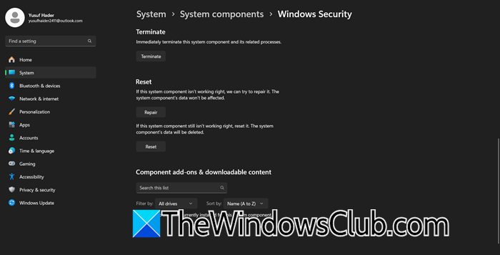

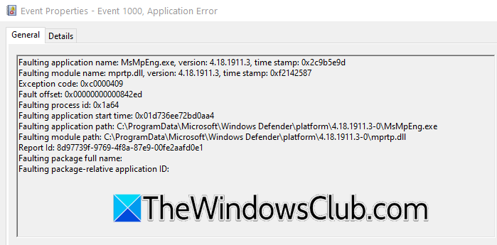

9] Faulting application name msmpeng.exe
The msmpeng.exe process is part of Windows Defender, also known as the Antimalware Service Executable. The error typically indicates that the Windows Defender process has crashed or failed to function properly. In such situations, start the troubleshooting guide by restarting Windows Defender, and if the issue continues, check for malware, and reset Windows Defender.
To do so, go to the search bar, search Windows Security, right-click on it, and select Apps settings. Lastly, click on the Reset option to automatically reset Windows Defender. This should resolve the issue. If the issue persists, click on Repair to see if that helps. You can also, try repairing the system files using SFC and DISM commands (mentioned earlier).
