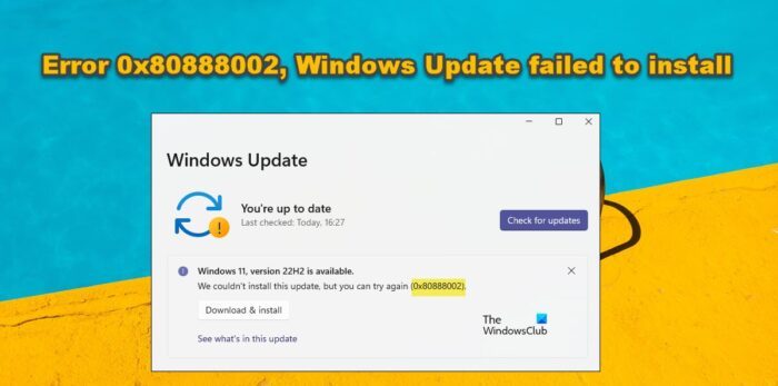

If you encounter Error 0x80888002, Windows Update failed to install, while updating or upgrading Windows 11/10, then this post will be able to help you. Some users have seen this error code when they try to install a Feature Update. The error message reads – We couldn’t install this update, but you can try again (0x80888002).
What causes Windows Update error 0x80888002?
If you have bypassed the installation check while installing Windows 11 or use some tool to install Windows 11 that automatically bypasses the security check, the error code will appear. When installing the 2022 version or 22H2, Windows check your system to make sure you have all the hardware required to install Windows 11, the lack of which results in the 0x80888002 error code. There are some other reasons and solutions that we will go over in this post.

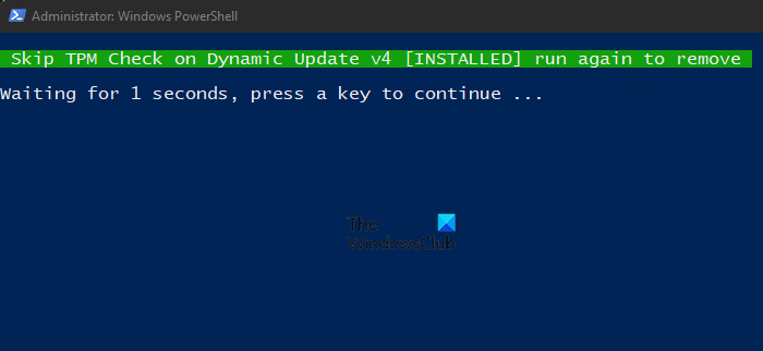

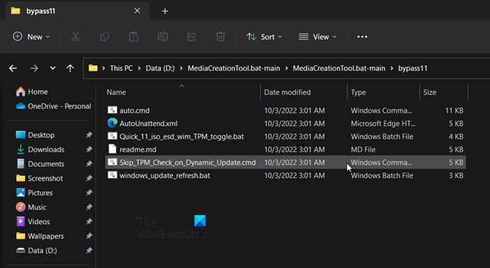

In order to resolve the issue, by running a script that can bypass the checking required to install this version of Windows. To install that script, you need to go to github.com and download the MediaCreationTool.bat by clicking on Code > Download ZIP.
Once the file is downloaded, extract it and then navigate to MediaCreationTool.bat-main > MediaCreationTool.bat-main > bypass11. Then, right-click on Skip_TPM_Check_on_Dynamic_Update.cmd and select Run as administrator. Click Ok when the UAC prompt appears. You may also Windows Defender pop-up, click on Run anyway.
Finally, follow the on-screen instruction to complete the process.
You should revert the changes after installing the update, to do the same, just go to the same location and run the Skip_TPM_Check_on_Dynamic_Update.cmd again. Instead of installing, the script will give a message saying that it’s now removed.
