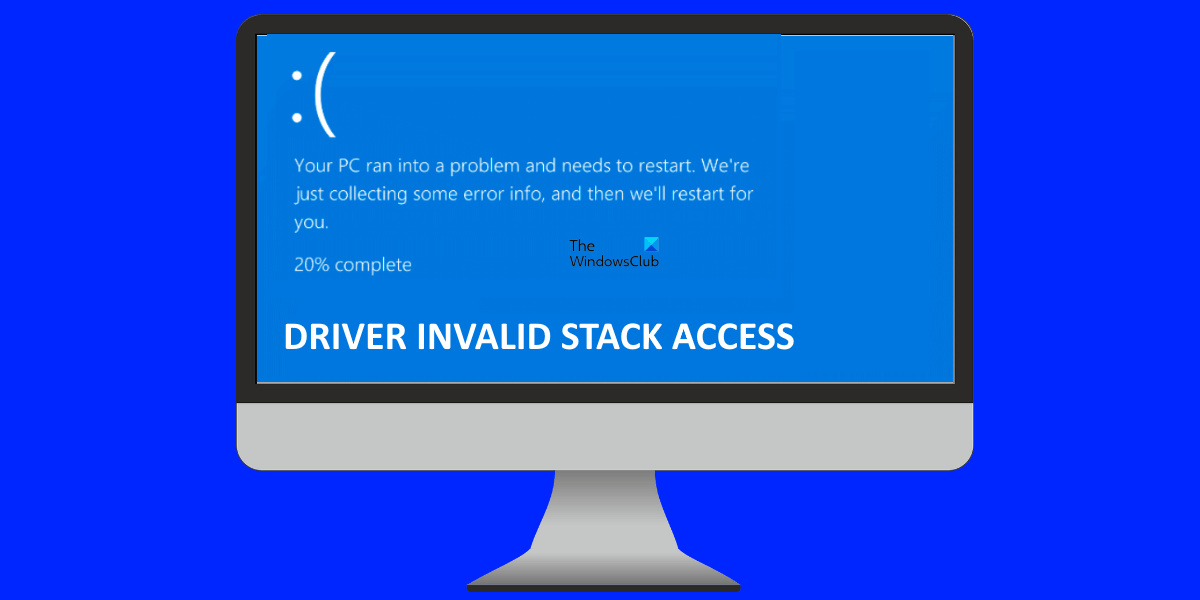

You see a BSOD (Blue Screen of Death) error when your system reaches a critical condition where it can no longer operate safely. It is also called Stop Error. It is an attempt by Windows to protect your system from critical damage. This article discusses solutions to fix the DRIVER INVALID STACK ACCESS Blue Screen on Windows 11/10.
The DRIVER_INVALID_STACK_ACCESS bug check has a value of 0x000000DC. This indicates that a driver accessed a stack address that lies below the stack pointer of the stack’s thread.

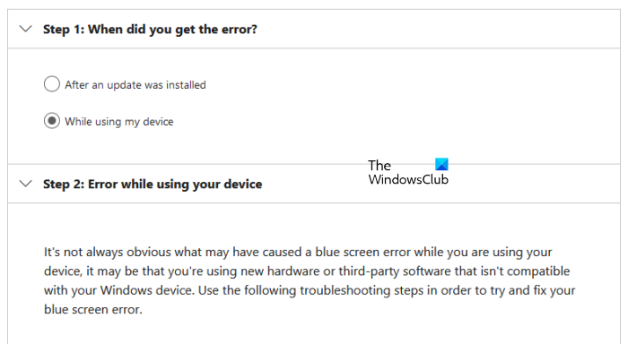

1] Run Online Blue Screen Troubleshooter
Online Blue Screen Troubleshooter is not a tool you can run on your system. Instead, it provides users with some suggestions to fix the BSOD error based on their feedback. You have to provide some basic information like when you saw the Blue Screen of Death error; after installing an update or while using the system, etc. Based on your input, the troubleshooter will provide possible solutions to fix the error.
