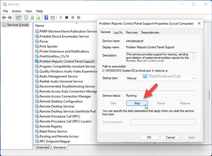

3] Disable these Services
There are two services that could be responsible for this issue. These two services basically report problems. In other words, they use the Device Manager to report problems on your PC. That said, Device Manager is in use when those services run in the background. Therefore, follow these steps to disable Problem Reports Control Panel Support and Windows Error Reporting Service:
- Search for services in the Taskbar search box.
- Click on the individual search result.
- Double-click on the Problem Reports Control Panel Support service.
- Click the Stop button.
- Click the OK button.
- Do the same with Windows Error Reporting Service.
Then, check if the Device Manager is acting the same or not.

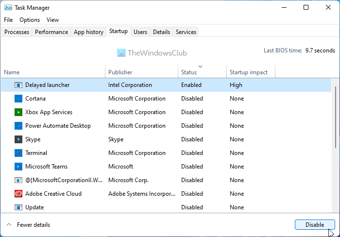

4] Remove programs from the startup
If unnecessary programs run at the startup and they use external devices, the Device Manager could refresh itself automatically. That is why you can remove programs from startup and check if it resolves the issue or not. You can use Windows Settings, Task Manager, WMIC, or anything else to get the job done.
