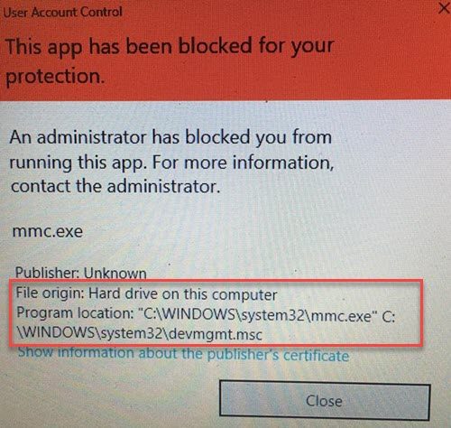

Device Manager in the Windows operating system allows users to view and control the hardware installed on their computer. We can also use this utility to update, uninstall, or roll back device drivers. However, some Windows users are unable to open the Device Manager because it has been blocked by their administrator, or that’s what the error message says. In this article, we will learn what to do when the Device Manager is blocked by the administrator in Windows 11.
Fix Device Manager blocked by administrator in Windows 11/10
There are various reasons why an administrator might not want you to make changes to device drivers. Most of them are related to security, but they can also be to streamline user experience. One of the reasons for blocking the Device Manager is security because it prevents malicious software and users from tampering with the hardware configuration. However, a lot of users who are actually not a part of an organization or whose computer is not controlled by an admin get this error. Also there could be cases, where an administrator has not made any changes but the app is blocked. In any case you can execute the following solutions to resolve the issue.

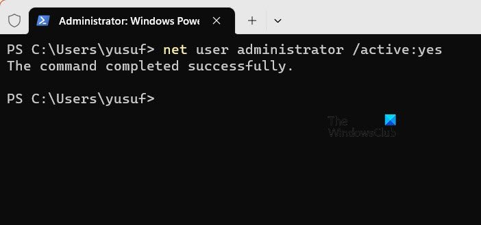

1] Turn on the super administrator account and then run it
There is a built-in administrator account that comes with Windows 11 and it allows computer manufacturers to install any apps without creating a user account. To prevent unauthorized access, the account is hidden by default. If you are unable to open Device Manager due to a lack of access, enable the hidden super admin account and then try to open Devices Manager. Follow the prescribed steps to enable hidden administrator:
- Press the Windows key and type Command Prompt.
- Right-click on Command Prompt and select Run as administrator.
- Here, click on the Yes button.
- Enter the following command in the command prompt.
net user administrator /active:yes
After running this command, now see if you are able to open Device Manager.

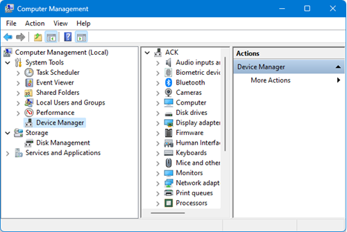

3] Open Device Manager with alternative methods
There are other methods by which you can launch the Device Manager, we have mentioned two of them below. Just go through them and see if either of them works for you.
- Launch Device Manager from Computer Management: Launch Computer Management from Start and click on Device Manager placed under System Tools.
