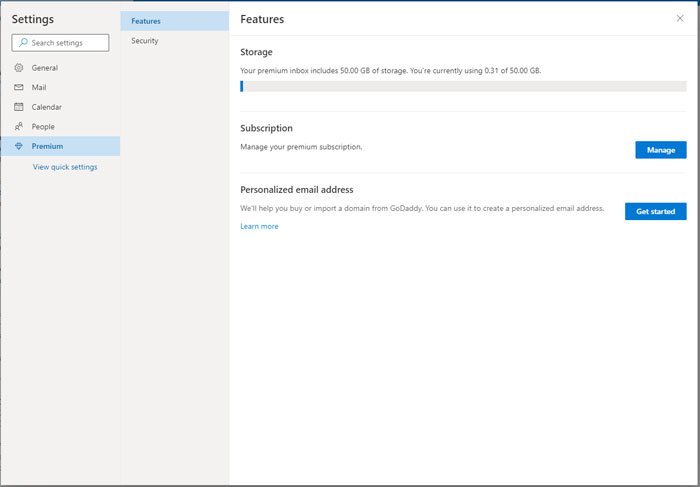

To begin, sign in to your Microsoft account that you used to purchase a Microsoft 365 subscription. Click on the setting gear icon that is visible on the top navigation menu. Following that, click on the View all Outlook settings option. It should open the Settings panel of Outlook.com.
As you already have the ‘premium’ subscription, you can click the Premium tab to explore more options. After that, click the Get started button under Personalized email address heading.

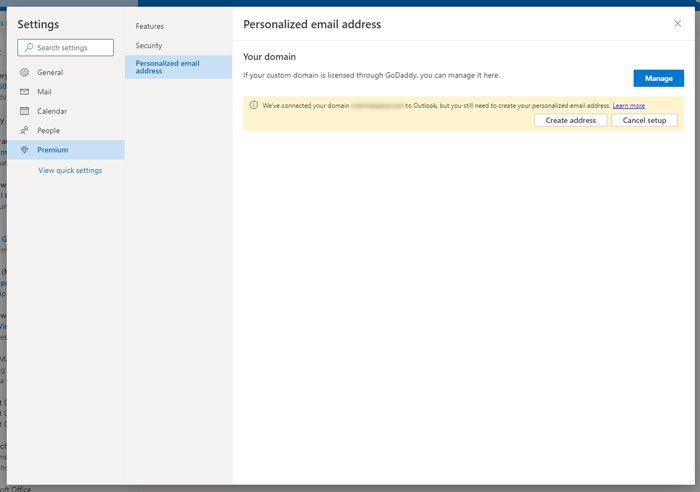

At this time, Outlook adds some DNS records to your GoDaddy account so that you can use the personalized email address to send and receive an email. To be precise, it adds two CNAME records, one MX record, and two TXT records. After finishing the last step, you can go back to the Premium tab where you can see a new sub-entry called Personalized email address. You need to visit this tab and click the Create address button.
It will let you create the email address that you want to get. In the next window, you have to type the desired email address. It can be anything – [email protected], [email protected], etc.
After writing down the email ID, click the Next button. If everything goes correctly, you will be greeted with a message like this-
Now, you can visit the Premium > Personalized email address tab to find your custom email ID. To send an email from your newly created email address, you need to change the address in the From section while composing an email in Outlook.com.
