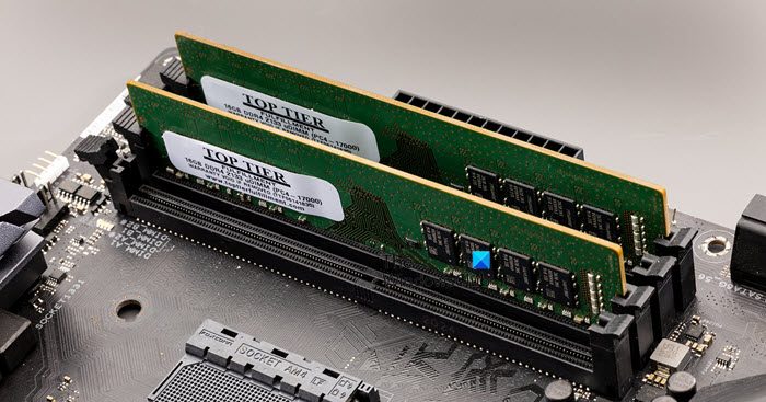

2] Reseat the RAM stick
Next up, we are required to check and make sure that the RAM stick is seated perfectly into its slot. If the connection is not tight, your memory card can wobble especially if your fan is running. So, unplug your cables, remove the RAM stick, and slot it perfectly and firmly.
First of all, you need to remove the back panel of the case and reach the RAM slot. After locating the RAM slot, push down the lock tab from both ends to free it up. Make sure to align the RAM stick with the slot, ensuring that the notch of the RAM stick matches that of the slots. Ensure that it is centered between the latch locks. Apply pressure to insert the RAM stick straight down until it clicks into place. It may require some force, but this is normal.
3] Attach the RAM stick to a different slot
There is a possibility that your RAM stick is fine, but the slot has malfunctioned. In that case, take out the RAM stick, and attach it to some other slot. You can also try cleaning the slow and making sure that no dust or debris is stuck in there.
