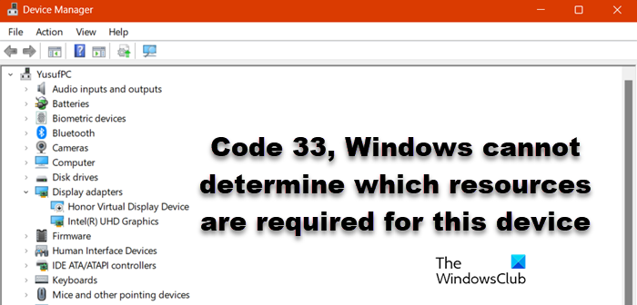

Some Windows users reported that they get Error Code 33 as Windows cannot determine which resources are required for this device in Device Manager. This Device Manager Error Code means the BIOS translator that determines the kind of resources required by the device has failed. In this post, we will talk about this issue and see what you can do to resolve it.
Fix Code 33, Windows cannot determine which resources are required for this device
If you get Code 33 in Device Manager and Windows cannot determine which resources are required for this device, follow the solutions mentioned below.
