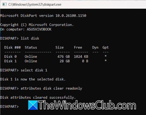

2] Remove write protection
Some affected users explained that they did not see the Delete option in the right-click context menu. Also, pressing the Delete key on the keyboard does not work. This usually happens when the storage device is write-protected.
If such a thing happens to you, your SD card might be write-protected. Clear the attributes using DIskpart. Follow these steps:
Click on Windows Search and type Diskpart. Press Enter. The UAC prompt will appear. Click Yes.
The Diskpart utility will open. Now, type the following commands and press Enter after typing each of these commands:
list disk select disk # attributes disk clear readonly
In the above command, replace # with the correct disk number (SD card in your case). These commands will clear the read-only attributes on your SD card. After clearing the read-only attributes on your SD card, you will be able to delete the files.

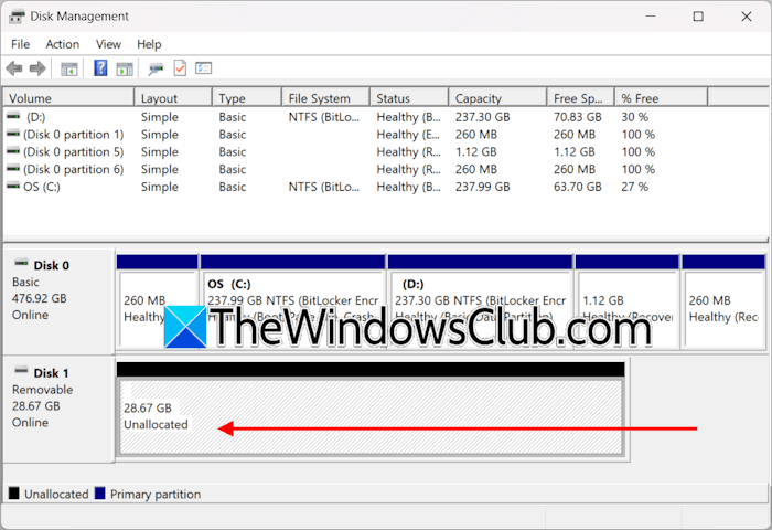

6] Use the Disk Management
If you cannot format the SD card, you can use Disk Management to delete the volume. This action will also erase all the data from your SD card. Therefore, back up all your important files before proceeding.
Follow these steps:
- Open the Disk Management.
- Right-click on your SD card and select Delete Volume.
- Click Yes to continue.
Be careful while performing the above steps, as incorrect selection will erase your important data. Therefore, select the right storage device (SD card) in Disk Management. You will see the Unallocated space on your SD card in the Disk Management. If you open the File Explorer, you will not see the SD card there.

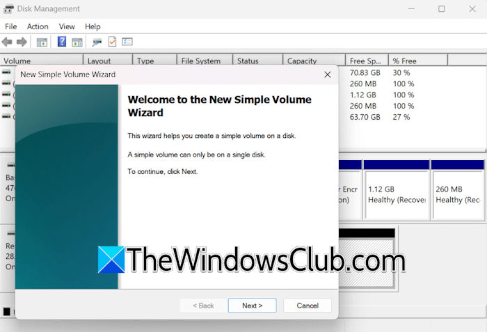

Now, follow these steps:
Right-click on the Unallocated space in Disk Management and select New Simple Volume. The New Simple Volume Wizard will open. Click Next and assign a new drive letter. Click Next and then click Finish. You will be asked to format the SD card. Click Format.
