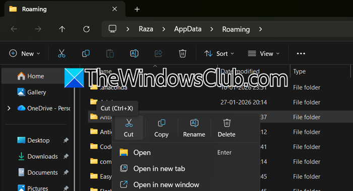

1] Perform a Clean install
A clean reinstall resolves conflicts and repairs corrupted core files by removing all installation traces before setting up the IDE with the correct permissions. You need to follow the steps mentioned below to do the same.
- First, uninstall Antigravity IDE from your computer.
- Now, hit Win + R, type %APPDATA%, and delete any Antigravity folder you find there.
- Navigate to C:\Users\<Username>\ and delete the .antigravity folder.
- Download the latest installer from the official website and run it on your computer/
- During installation, choose the Just Me option if prompted.
Finally, open the IDE and see if the issue persists.

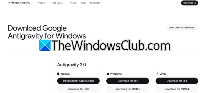

3] Restore the missing interface
By restoring the missing interface, we can ensure that you have installed the correct developer version of the product, as Google has split its offering into two separate applications. So, first, uninstall any existing Antigravity installation (both the main app and the IDE). Then, go to the official Google Antigravity website (antigravity.google) and download the version named Antigravity IDE (the developer version). Then, install only the Antigravity IDE first.
Only after the IDE is fully installed and set up can you choose to install the standard “Antigravity” app. Finally, launch Antigravity IDE; your full code workspace should now appear.
