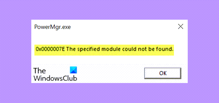

This post shows you how to fix Error 0x0000007E—The specified module could not be found that appears in the PowerMgr.exe dialog box. This error message appears every time you reboot or power on a Lenovo desktop or laptop, such as a Thinkpad. In this post, we will offer the most suitable solutions you can try to resolve this issue successfully.
PowerMgr.exe is an executable file that belongs to the Lenovo Power Manager Host process which comes along with the Lenovo Power Manager Software developed by Lenovo software developer.
The issue occurs because the Lenovo Power Manager app is installed on the computer. This application is installed to save energy consumption and hold the file system’s state in RAM in the Reset, On, Idle, and Suspend power states.
0x0000007E, The specified module could not be found
