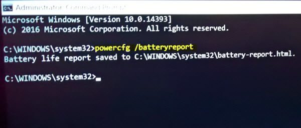

5] Create Battery Health Report
Generate a Battery Health Report and check. To do this, open Command Prompt, type powercfg /batteryreport and hit Enter.
You can then access the report, which will be saved as – C:/Users/username/battery-report.html.
See if anything here helps you.
