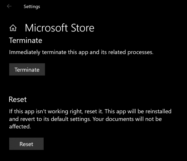

3] Reset Microsoft Store
If the error you are currently facing persists, you can reset Microsoft Store via Settings app or using the wsreset.exe command. Keep in mind that performing this task, all the cache files in Microsoft Store will be cleared. It will permanently delete the app’s data on your device, including your sign-in details.
To reset Microsoft Store via the Settings app on your Windows 11 device, do the following:
- Open Settings app.
- Click on Apps > Apps & Features.
- Scroll down to Microsoft Store on the list.
- Click on the ellipsis (three dots} button.
- Select Advanced Options.
- Scroll down and click Reset.
- Exit Settings app when done.
To reset Microsoft Store via the Settings app on your Windows 10 device, do the following:
- Open Settings.
- Click Apps > Apps and features.
- Search for or scroll to find Microsoft Store.
- Next, click on the entry once to expand its options.
- Now, click the Advanced options link.
- On the page that opens, scroll down and click the Reset button.
- Exit the Settings app when done.
