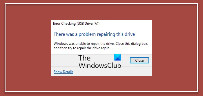

If you connect a USB, SD Card or Hard Disk to your Windows 11/10 PC and you see, an error box – Windows was unable to repair the drive, then it means that the file system on the drive has become corrupted and ChkDsk is unable to repair it. You may also see this message when you try to run ChkDsk to repair the file system.
There was a problem repairing this drive. Windows was unable to repair the drive. Close this dialogue box, and then try to repair the drive again.
The most probable causes of the issue are that either the user might have pulled out the external drive directly without using the “Safely remove hardware” option, or when the drive was in use or general corruption of the content.
There was a problem repairing this drive, Windows was unable to repair the drive
