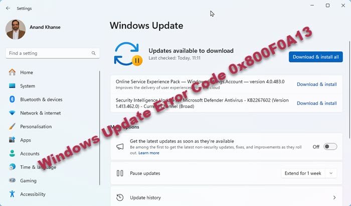

At times, you may encounter Windows Updates Error code 0x800F0A13 while installing certain updates. This could be caused due to corrupt or missing system files. When you run Windows Update, you could see the following error message:
Error(s) found: Code 0x800F0A13 Windows Update ran into a problem

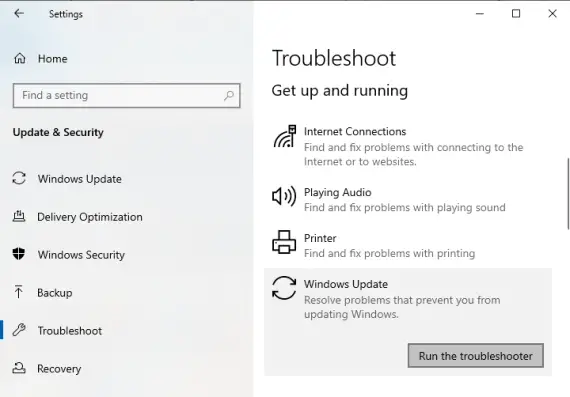

1] Use the Windows Update troubleshooter
In order to fix the error code 0x800F0A13, the first and foremost tip I recommend you run Windows Update Troubleshooter. It potentially resolves most of the problems related to the Windows Update. Here is how to do:
To do it, click on Start > Settings > Updates and Security > Troubleshoot.
Move to the right pane, scroll a bit, and then select Windows Update.
Click on Run the troubleshooter and let Windows fix the problem automatically.
Once it completes the process, restart your device and check if it resolves the problem.
