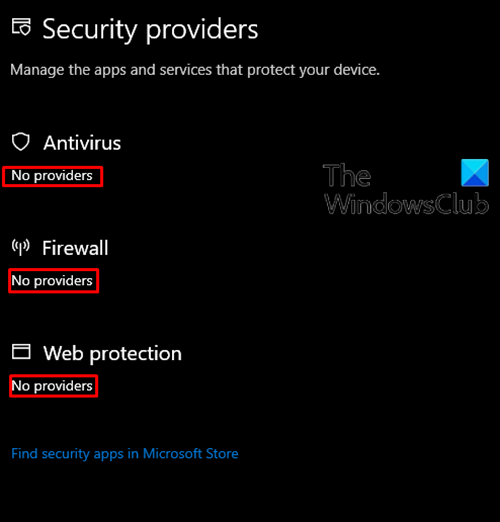

Sometimes Windows can’t run a virus scan in Windows Defender and says that there are no security providers for Antivirus, Firewall, and Web protection in Windows Security settings. This issue can be caused by but is not limited to corrupt system files, malware infection, and disabled Windows Security service. In this post, we will learn what to do when Windows Security says No Security Providers in Windows 11/10.
Windows Security says No Providers
If Windows Security is not working and showing a message that there are No Security Providers for Antivirus, Firewall, or Web protection then, execute the solutions mentioned below.

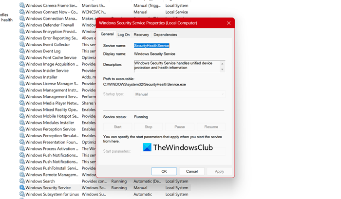

1] Make sure the Windows Security Service is running
If the Windows Security Center Service is turned off, you will most likely be faced with this issue. In this case, you need to verify that this essential service is running. Windows Security Service handles unified device protection and health information.
Also ensure that the Remote Procedure Call (RPC) Service on which it depends, is running. It should be set to Automatic startup.
Next, check if the Security Center Service is started and set to Automatic (Delayed Start) startup.
If this doesn’t resolve the issue, continue with the next solution.

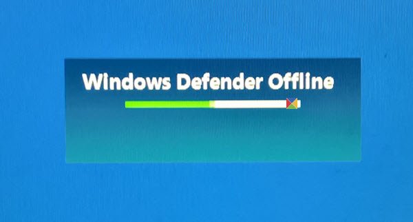

4] Perform Windows Defender Offline Scan at boot time
Windows Defender in Windows 11/10 allows you to conduct an offline scan – also referred to as Windows Defender boot-time scan – that can help you get rid of persistent and difficult-to-remove malware and malicious software, using the latest threat definitions.
If the issue persists after you have performed the offline scan, you can try the next solution.
