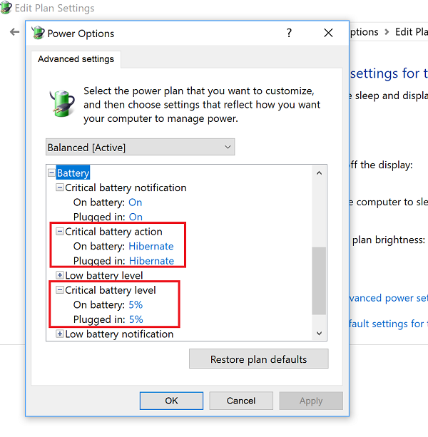

3] Switch to High Performance Power Plan
Power Plans are available in the Control Panel. You can switch to the high-performance power plan if you are experiencing slow performance on your laptop. It may help. Go through the following instructions:
- Open the Control Panel.
- Type Power in the Control Panel search bar.
- Select Power Options from the search results.
- Now, select the high-performance power plan.
If the high-performance power plan is not available, you can restore it and other missing default power plans via the Command Prompt.

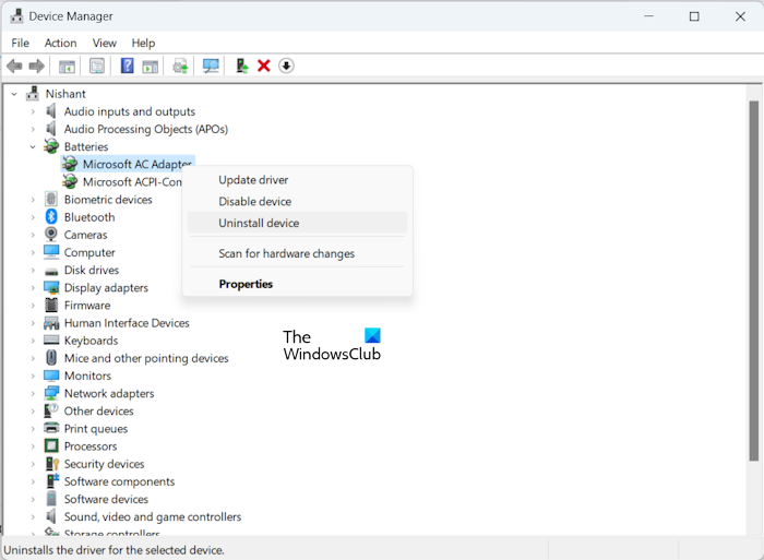

5] Reinstall your battery driver
The next thing you can do is reinstall your battery driver. Battery drivers are not available on the official websites of all computer manufacturers. Therefore, the process of installing the battery driver is not as straightforward as installing other drivers on a Windows computer. Before you uninstall your battery driver, I recommend you create a system restore point.
Open the Device Manager and uninstall your battery driver. After doing that, restart your laptop. This will reinstall the battery driver. If this does not fix the issue, you can try other ways to download and install the battery driver.
