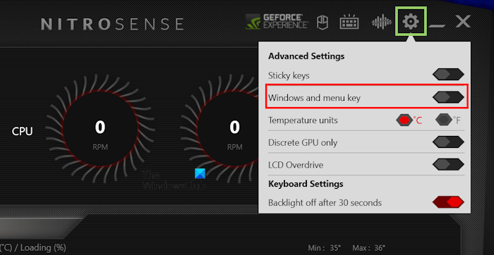

2] Have you installed Acer NitroSense?
NitroSense software is developed by Acer for Acer computers. Using this software, users can monitor their CPU and GPU temperatures, change the power plan settings, and adjust the fan speed. If you have installed Acer NitroSense software, you might be facing this problem due to it. Check its settings to confirm this.
- Open the NitroSense software.
- Click on the gear-shaped icon on the top right side.
- Turn on the “Windows and menu key” button.
After turning on this feature, the issue should be fixed.

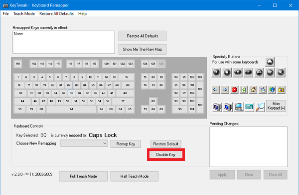

5] Map your keys
You can also use a keyboard key mapper software to map your keyboard keys. Using this software, you can assign a particular function to your keyboard keys. There are a lot of free tools available that allow you to map your keyboard keys.

When you press the Windows key and select it for mapping, the software shows the key you pressed. If the Play and Pause key is mapped to the Windows key, the software will show you the Play and Pause key on pressing the Windows key. If the software shows the Win key after pressing the Windows key, you cannot use the keyboard mapper software or PowerToys. This is because the same keys cannot be mapped.
