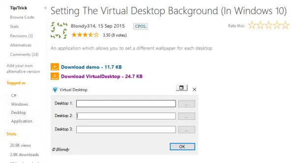

However, if you are using Windows 10, you can use a software called VirtualDesktop that you can download from CodeProject. It is a free app, and no installation is needed. Simply download and extract the folder and the application is ready to use. However, the user would have to make a CodeProject account and login to it.
The user would have to make a CodeProject account and log in to it.
