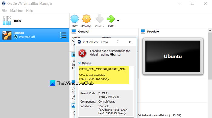

We have noticed that sometimes, VirtualBox fails to start a virtual machine session and throws the VERR_NEM_MISSING_KERNEL_API VirtualBox error. When going through the log file, we noticed that it says Attempting fall back to NEM which means that since hardware virtualization is not available or is inaccessible at the moment, VirtualBox is trying to use NEM. In this post, we will discuss this issue in detail and see how you can resolve it.
(VERR_NEM_MISSING_KERNAL_API).
VT-x is not available (VERR_VMX_NO_VMX).
Fix VERR_NEM_MISSING_KERNEL_API VirtualBox Attempting fall back to NEM
If you get VERR_NEM_MISSING_KERNEL_API VirtualBox error and VirtualBox is attempting to fall back to NEM, you should first reboot your computer, and if that is to no avail, update your BIOS and the host operating system. If didn’t work, follow these solutions to resolve the issue.

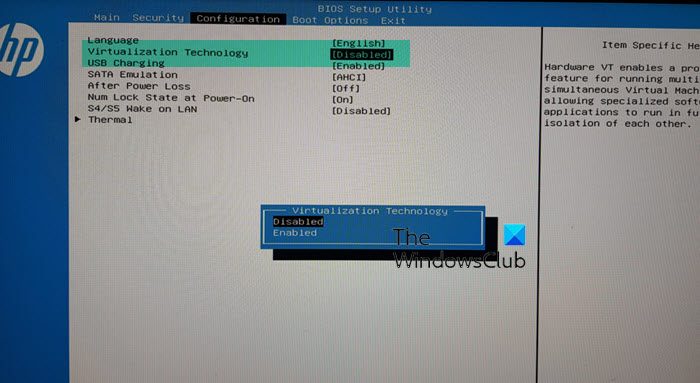

1] Check and make sure that the Hardware Virtualization is enabled
As clearly mentioned in the error message, the Hardware Virtualization or VT-x is not enabled or is inaccessible at the moment. So, an obvious solution would be to check if that is the case and enable the feature if required. To do the same, you can follow the steps given below.
- First of all, boot into BIOS.
- Navigate to the Configuration tab.
- Look for Virtualization Technology and set it to Enabled.
However, if you can’t find these options, check our guide to enable Hardware Virtualization for all OEMs.
After enabling Hardware Virtualization, check if the issue is resolved. In case, it was already enabled, move to the next solution.

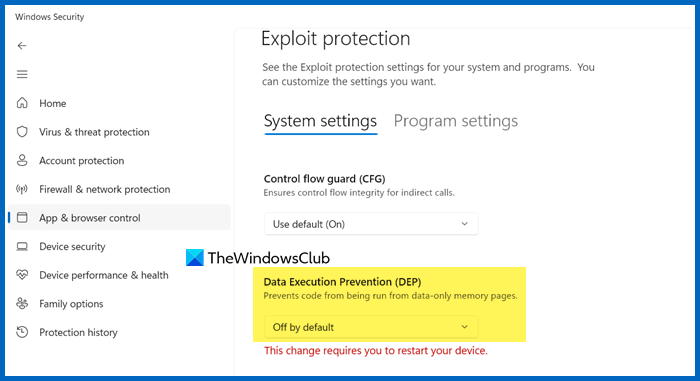

3] Disable Core isolation and Data Execution Prevention (DEP)
Memory Integrity > Core Isolation prevents attempts to inject and run malware in high-security processes by making kernel memory pages executable only after passing an integrity check with the help of virtualization. Therefore, it should be disabled. Even though Data Execution Prevention (DEP) has nothing to do with virtualization, it sometimes conflicts with some functions of Virtualization, hence, should be disabled if encountering VERR_NEM_MISSING_KERNEL_API error.
To disable Core isolation and Data Execution Prevention (DEP), follow the steps mentioned below.
- Open the Windows Security app by searching it out of the Start Menu.
- Then, go to App & browser control.
- Scroll down and look for Exploit protection and then click on Exploit protection settings.
- Now, go to Data Execution Prevention (DEP) and change it from Use default (On) to Off by default.
- Then, click on the Device security tab from the left section.
- Go to Core isolation and click on Core isolation details.
- Finally, disable the toggle for Memory integrity.
You have to restart your computer for these changes to be applied. Once you do that, check if the issue is resolved. However, before restarting, check out the next solution.
