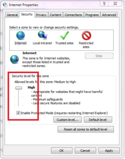

1] Toggle Internet Options settings
Search for Internet Options in the Windows Search box and open the Security tab.
For all the given Zones, bring the security slider to the lowest possible security. Click on OK to save changes and close Internet Options.
Now this can only be a temporary measure as it leaves your computer vulnerable, so once your work is done, make sure to press the Reset all zones to default level button.
