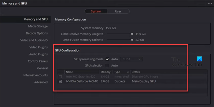

1] Check the GPU Configuration
Our first step is to check and make sure that the GPU is configured in DaVinci Resolve. To do so, you need to click on the Update Configuration button from the error message box. Then, go to the Memory and GPU tab and check the GPU Configuration section. The GPU processing mode should be checked and set to Auto, and your dedicated GPU should be enabled. After making the changes, quit the settings panel, and restart the app to check if the issue persists.

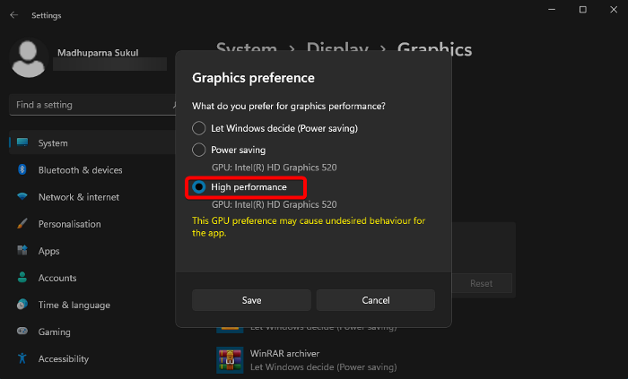

3] Force DaVinci Resolve to run with the dedicated GPU
Swapping the HDMI cable from integrated to discrete GPU might work in some instances; however, we have to go the extra mile and force the app to always run with the dedicated GPU. To do so, you can follow the steps mentioned below.
- Open Settings.
- Go to System > Display.
- Then, go to Graphics from the Related Settings section.
- Now, look for DaVinci Resolve Studio. If you can’t find it there, click Browse, navigate to its location, and select its EXE file.
- Then, click on Options, from the Graphics Preferences window, you need to select High performance, and finally, click on Save.
Now, try running DaVinci Resolve and see if the issue is resolved.

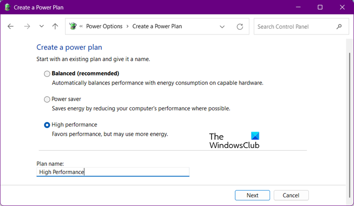

4] Use High or Ultimate Performance Power Option
If switching to a dedicated GPU doesn’t work, we need to aim to extract as much processing power as possible from our computer. So, we will try shooting for High-Performance mode. In case that doesn’t work, we will switch to Ultimate Performance mode.
To do so, follow the steps mentioned below.
- Open Control Panel.
- Then, go to Hardware & sound > Power Options.
- Now, select High performance.
- If it is not available, click on Create a power plan, and select High performance.
- Click on Next, and finally, set to High performance.
Once you have configured and enabled High-performance mode, check to see if the issue is resolved. If that does not help, go ahead and enable Ultimate Performance Power Plan.
